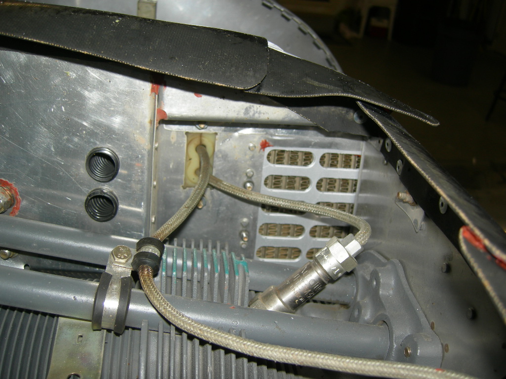

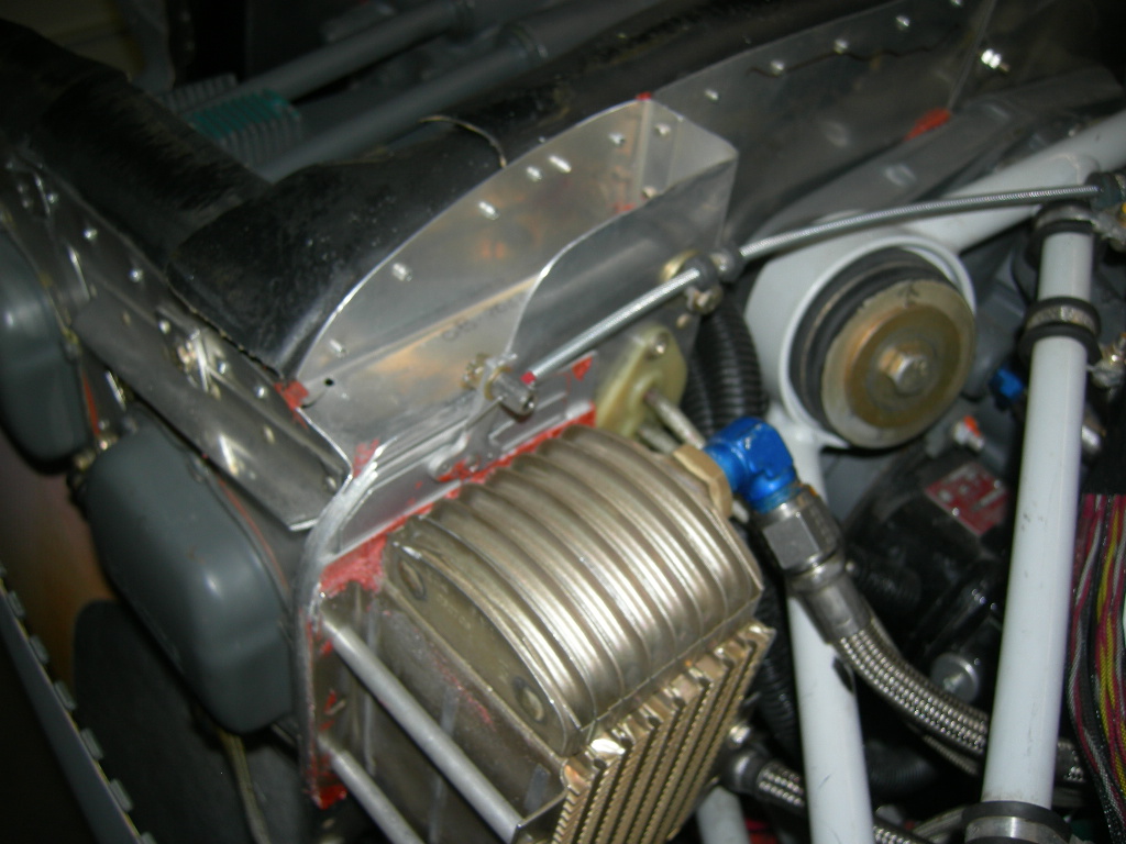

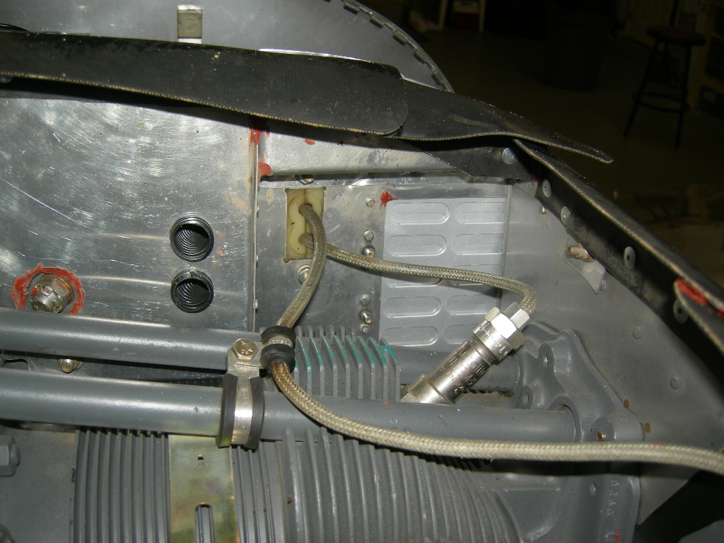

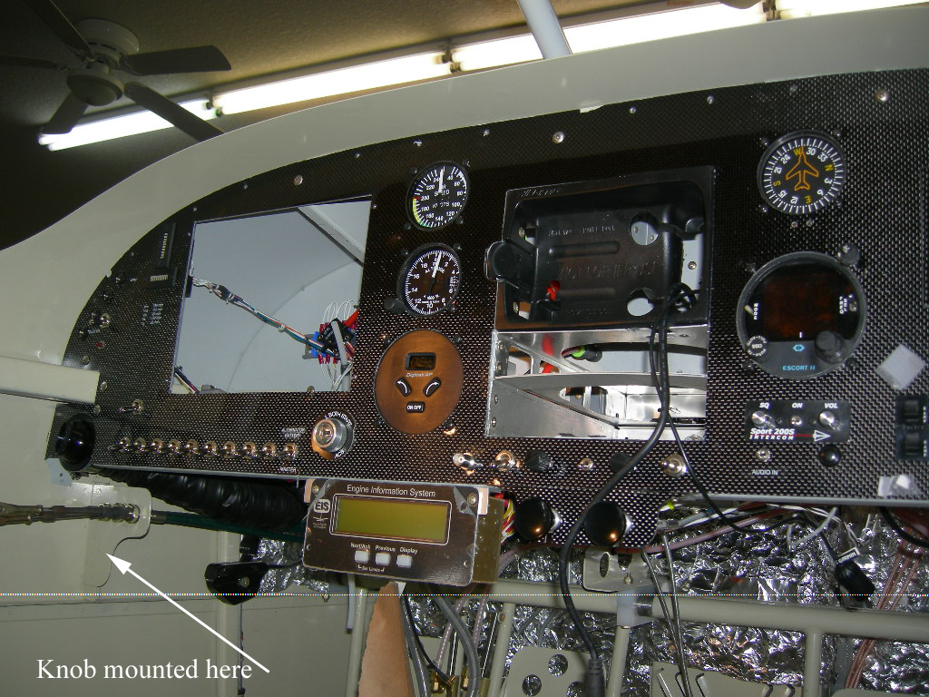

PostPosted: Thu Jan 07, 2010 7:04 am    Post subject: Van's oil cooler shutter Reply with quote
Hi Ralph,
Finally some pix. Let me know if they don't come through. I'll move it away from Yahoo. Unfortunately I didn't take a pic of the shutter before installation, but it is about 3/8 in thick and same width and length as the cooler. You mate it up to the cooler then, using the cooler as a drill guide, drill through the shutter for the mounting holes. Stick the bolts through the cooler and the shutter and then bolt that assy to the baffle. The control cable mounts to an arm that swings (aircraft) left and right to vary the shutter air opening. It mounts to this arm via a collar and set screw the same as the carb heat set up. Be certain you have upper cowl clearance before final assembly. As you can see from the photos, the shutter, when fully opened still blocks a portion of the air into the cooler. I have NOT determined if or how much effect this will have on summer activities. I suspect it will have some effect. If that is the case, removing the shutter is as simple as removing and reinstalling four bolts. Shouldn't even have to remove the oil lines. The hard part is messing with the cowl. I guess, just do it at oil change. The acuator cable is also from Vans. It's the standard cable they use for carb heat and cabin heat. I side mounted my throttle quadrant forward of the left arm rest - ala Dan Checkoway. The push pull knob is then attached to the small bracket that secures the engine control cables prior to entering the quadrant - just below the left airvent eyeball. Winter time flying works great. Jury still out on the hot summer Kansas days.
Congrats on Patience (love the name). Fly safe.
Steve Stucky
VariEze 282S
RV-7 283S (Wake Turbulence)

Hi Ralph,
