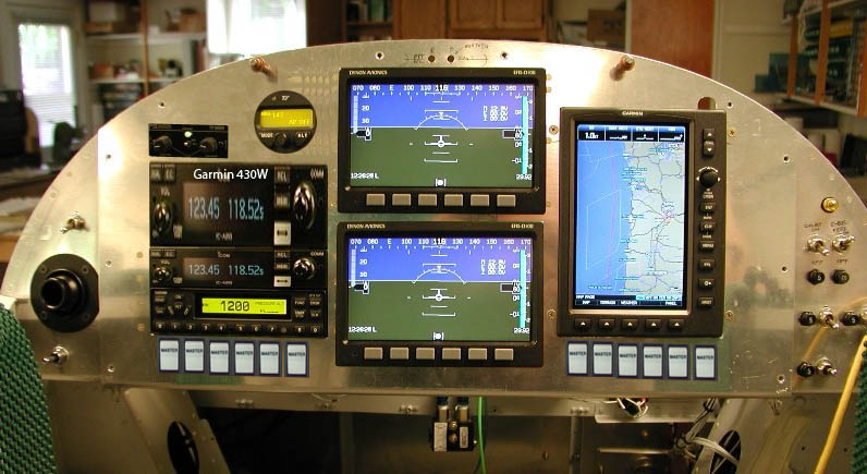

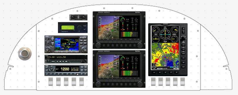

I am laying out my “Budget” RV-8A panel and have a transponder question. And yes I know this is the -10 list but I think I still have privileges here.
I am unclear what is the lowest priced Garmin Transponder that will ultimately work with ADS-B and other traffic warning systems.
I understand that the GTX-330 is their top of the line and is IFR certified but will the GTX-237 work with things like Navworx and TIS? It does not appear to be the case.
Robin
Phase 1 of Panel design (~$30K):
 Filesize:  98.08 KB
 Viewed:  12743 Time(s)
 Filesize:  38.54 KB
>>> Thanks,
>>> Robin

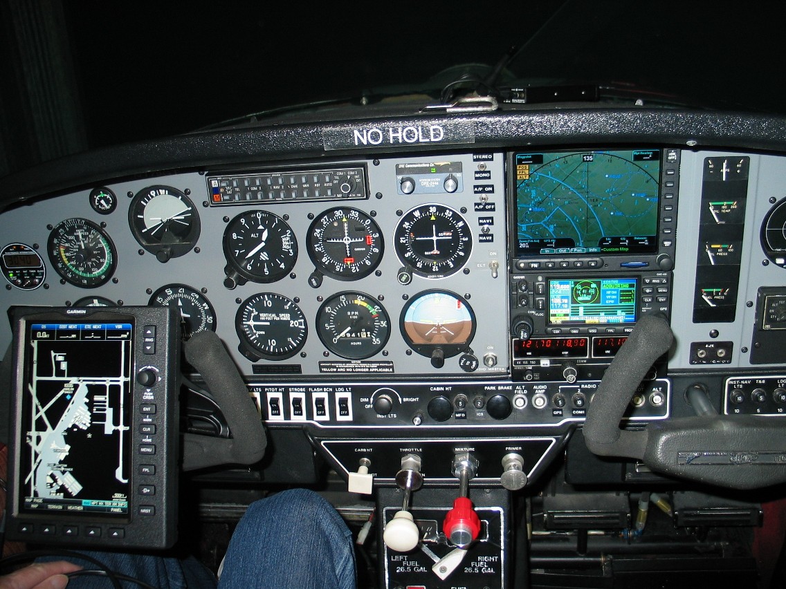

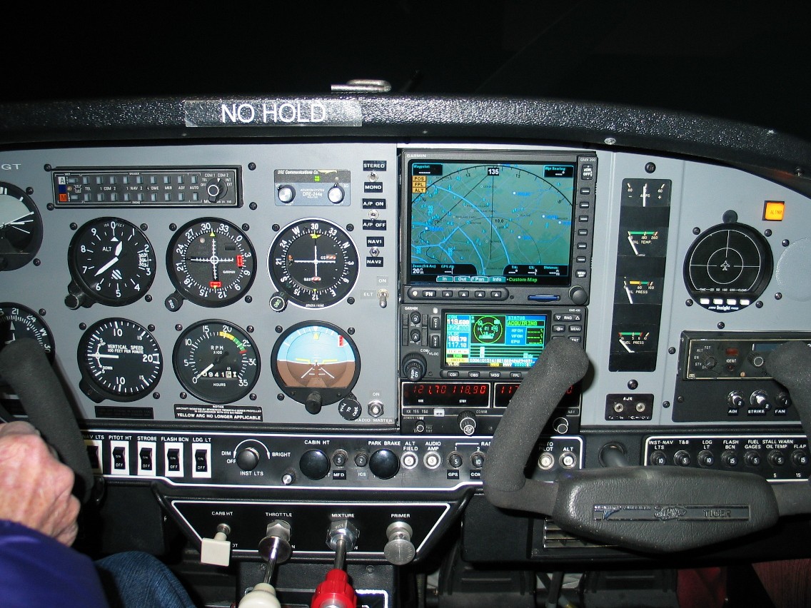

We bought this low-time Tiger last year and put in a 430 WAAS and a
GMX200.( Also bought a 696 which we love) This year we had a GTX330
installed, along with a PMA700 audio panel when our transponder went out
near Gorman in Calif. We love it. At least it shows the traffic vectors
for aircraft in the vicinity of busy airspace, and it can be upgraded
later...hopefully by someone who buys our Tiger after the farm sells, so
we can upgrade our plane. We want to fly all ver when we move to Ohio

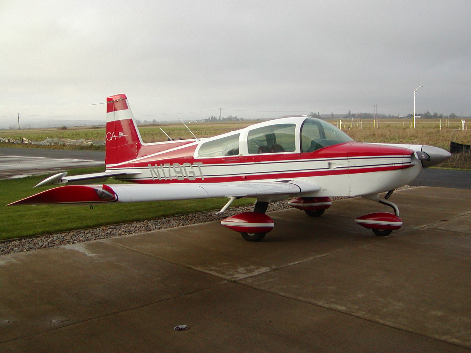

Hi TIm,
Ruth told me that the Tiger does well on grass. She has landed it on grass and taxied...does well. She has 2000 hrs, mostly in Tigers (110 hrs in an overpriced Cirrus SR20 we had for 6 months). When we sell (we do have two interested clients now), I will have to get my certificate before we sell it. But it will be so great to move on with our lives. Talk to you later Tim.
Brian
