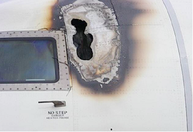

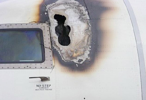

Here's a regional airliner after a lightning strike.

sorry, attachment didn't attach. Try again.

if it doesn't attach this time I'll give up.

Your picture Bob looks to be fire damage of the wire looms running to
the CB panels, aft of the CO's seat. It could indeed be lightning but
more likely the secondary effect of playing with Mother Nature on her
terms.

The imprint of Thor's hammer!

..... converting Bob's PDF to JPG so the attachment works on the mailing list.
Here it is:

This was not a lighting strike.....Cause by a fire inside while on the
Ground.

This URL offers a better image and explanation of that photo:
http://www.snopes.com/photos/airplane/lightning.asp

Man that was some big hole!

I was mis-informed about the lightning photo (too gullible, I guess). Thanks for the correction.
But I'm still worried about the non-conducting fiberglass cabin, when it comes to lightning.
