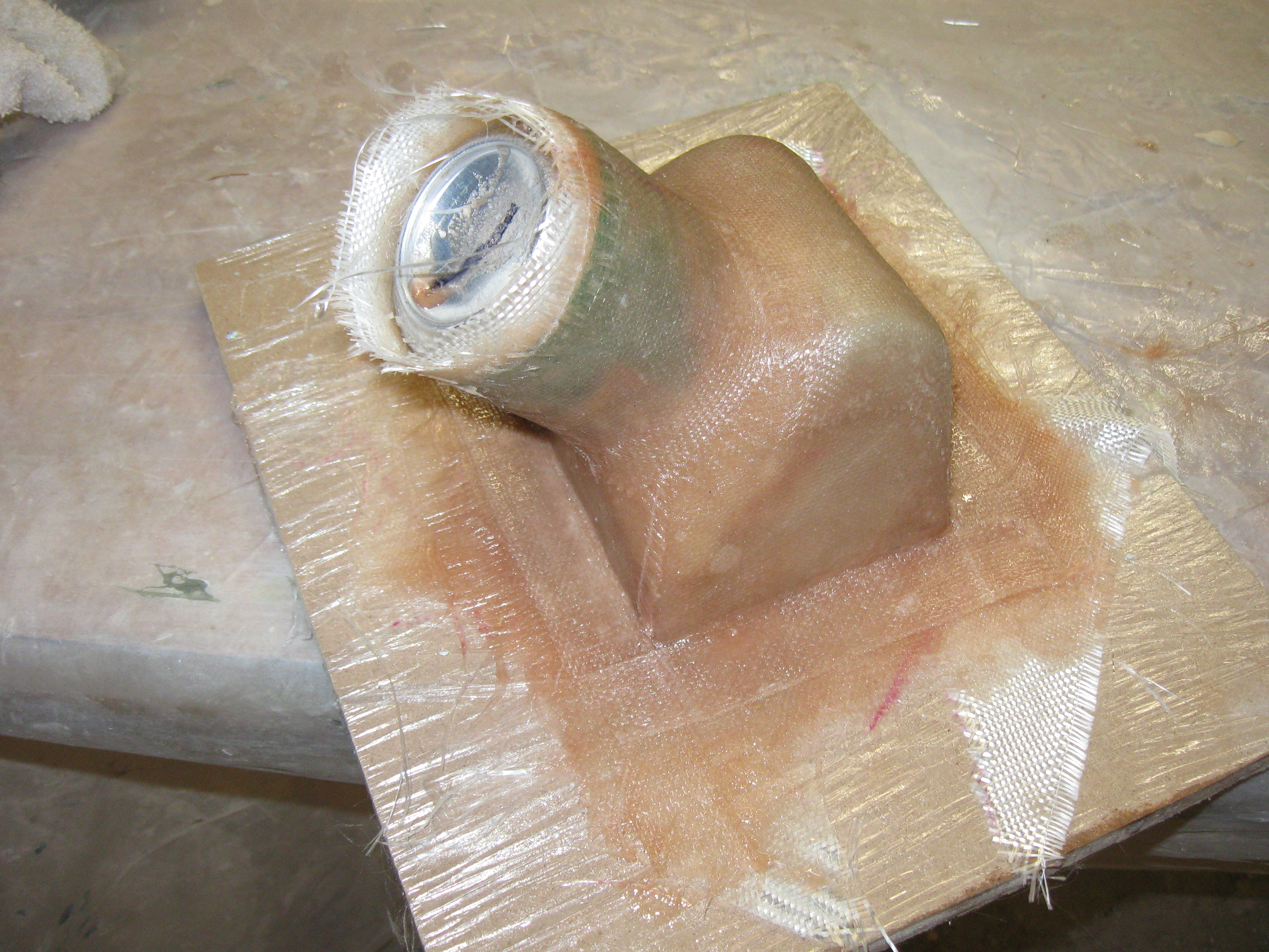

I have attached a picture of a plenum I laid up that will fit my oil cooler. The plenum will be attached to some ducting and then to a NACA vent on my Europa's cowl. With that in mind I was wondering if anyone has scavenged the "hot air" off the oil cooler and used it as a source for cabin heat? Any pictures or input would help?

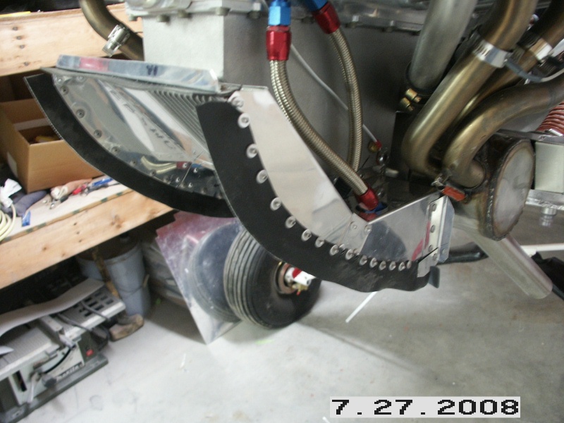

Just a picture of mine on my highlander

When you need the cabin heat, the oil will not be hot enough to do you any good with the OC on line. I cut off the air to my oil cooler in the winter. Stick with the standard heat muff on the exhaust, for my 2 cents worth.
Paul
