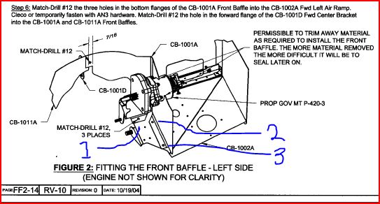

How did you guys get access to the screws that hold the front baffle, right underneath the prop governor? I am still trying to figure out how to drill it, let alone get a screw driver to it.
Hopefully, the image was attached okay below!
Also, are there any recommendations for exactly how to align the CB-1001A baffle in relation to the cowl? The plans don't give much info here. The plans also don't seem to indicate any baffle material for this area. I am wondering if I shoot for a tight fit or leave a gap for the cowl to come on and off?

A 90 angle drill and short threaded drill bits. Why hot put SS cap screws in
there with an Allen wrench.

I second the angle drill. Also, I use a #3 bolt & a universal socket.

ok, thanks for the replies. looks like i'll replace that screw with
something easier to access.
