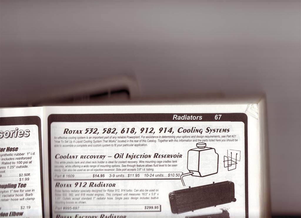

thesupe(at)hotmail.com
PostPosted: Tue Dec 08, 2009 9:53 am    Post subject: 503 oil injection retrofit Reply with quote
Tom C  my old CPS catalog shows a coolant recovery bottle which they say can also be used as a oil injection reservoir.  Part # 1609  price was $14.95  (in 2002)  Maybe they still sell it.  Jim Chuk
