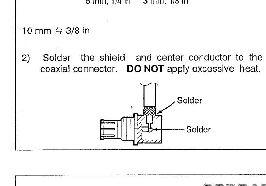

My 10 cents is that the 9-30-10 is not an adaptor. The item in the A200 installation picture attached is a 9-30-10 from lanepilot.com. $25.00 with shipping. (or $52 from ICOM)
This part was a supplied item with the A200. They stopped when they came out with the A210.
Now a question.
I have soldered the connection in two places as shown.
When I solder the antenna connector on the other end. Should I also solder the braid to the connector body or should I separate the braid and ground it to the airframe or should I trim it back and not solder it anywhere. (I soldered braid to connector body)
Reason I'm asking is that all I'm getting from the speaker is a hissing sound. To keep it simple I started by hooking up the speaker only. nothing else. I suspect my coaxial wire (RG58 A/U) because when I pull the coax out of the A200 the noise is unchanged……..Geoff

PostPosted: Mon Dec 14, 2009 11:06 am    Post subject: LOOKING FOR RIGHT ANGLE BNC CONNECTOR Reply with quote
Geoff -
The insulating and jacketing materials used in RG-58 are vulnerable to the temps encountered in soldering operations. RG-400 is much better suited to this application.
When using coax to feed an antenna, the shield must be electrically connected at both ends. On antennas that employ a BNC-type connector, the connector shells provide the circuit path from the radio case ground to the aircraft skin, which serves as the antenna ground plane. Whether the braid is soldered or clamped to the shell with some sort of threaded or crimped fastener is determined by the particular connector design.
It is quite possible that the heat of soldering was sufficient to melt the foam insulation separating the center conductor and the braided shield. If the two get together, things don't work so good, and transmitting could damage the radio's RF output circuit.
Finally, if you haven't checked/adjusted the radio's squelch setting, it may be set low enough that the hiss you're hearing is normal white noise. Tighten the squelch and see if the hiss goes away.
Neal
