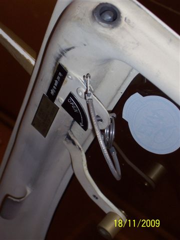

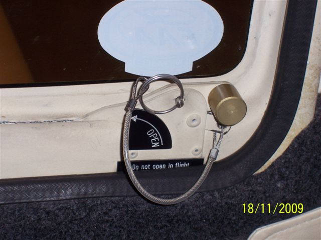

raimo.toivio(at)rwm.fi
PostPosted: Wed Nov 18, 2009 11:33 am    Post subject: Door locked inflight by pip-pins. Reply with quote
All,
so many of you have asked me to show my door security pip-pins that here they are.
Pip-pin connects the guard and the lever together.
Pip-pin has a safety lanyard.
Placards:
1) "do not open during flight" (both sides)
2) "open" with an arrow (both sides)
3) "Warning! Only the pilot is allowed to open - close - lock the door" (passenger side only!).
Last notice is because of security and partly because I do not like an idea to repair the internal parts of the door after somebody has locked it using unnecessary extra force.
They work fine and I feel good with them. I could not imagine possibility to fly without them.
Nice to be with you - Mr. Dave Conrad - in a same club flying with "locked" eh retarded doors...
Raimo OH-XRT
(flying with pip-pinned doors)
