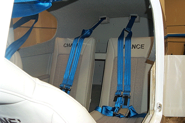

PostPosted: Tue Nov 03, 2009 10:09 am    Post subject: AMSAFE seat belts Reply with quote
www.inertialbelts.com is on line again. The belts are shown in my Glastar as the belts were not installed in my 10 at that time. Rene has good pictures of the final finish. I will enclose one of his here.

PostPosted: Thu Nov 05, 2009 2:57 pm    Post subject: AMSAFE seat belts Reply with quote
I've got a couple of questions David:
How much weight are we adding with the inertia reel belts as opposed to the standard?
The hard points you show in you installation pictures are much more elaborate than what Vans provides for the stock belts. Is there a reason the inertia belts require more support, or do you feel the Vans hard points aren't enough for either approach?

PostPosted: Thu Nov 05, 2009 6:55 pm    Post subject: AMSAFE seat belts Reply with quote
I think the overall concern is that the factory hardpoints are just not enough. I believe, as David said, AMSafe was concerned that additional reinforcement would up the safety margin. I know I feel a lot better after putting a couple of intersecting layers of S glass over the hardpoints.

PostPosted: Thu Nov 05, 2009 8:59 pm    Post subject: AMSAFE seat belts Reply with quote
Below is my reply to Jeff. I do believe that if you use the standard hardpoints and regular belts that you should at least use a CS stainless washer under the screw. This will spread the load on the glass and make a pull though more difficult.
don't know for sure but the total weight of four AMSAFE belts IIRC is less than 10 pounds. Incrementally I would say an additional 2-4 pounds over the standard belts. You add 4 3'x3'x1/2'' aluminum blocks and four rollers Check with Rene as he probably weighed the alternatives.
The existing hardpoints were deemed inadequate (for the AMSAFE application) by both AMSAFE and consultant (PhD, ME Caltech) who lives nearby. The vans hardpoints are setup for a single #5 counter sunk screw. This is installed without CS washer that would be required to spread the load. My ME consultant friend tells me that the normal use of the regular belts will cause micro fractures and may fail (pull through) if and when a crash occurs. AMSAFE commented that they would sell me the belts if I "beefed up" the existing hardpoints. Since the roller have screws for attaching the brackets I needed a means to attach the bracket Since I did not want 16 protruding though the lid I used the aluminum blocks (2024T3 or 7075) . These were tapped for 4 external screws to hold the pad that holds the roller. Each external screw has a .75" CS stainless washer and thereby spreading the load on the lid. In addition since the shoulder straps are on inertial reels there is no constant shear load on the single screw in the lid. The hardpoints areas were strengthened by additional E-glass and S-glass tapes. The calculations of the ME ,while informal, indicated that relative strengths could compared by comparing the surface areas of the fasteners. Hope this helps.

PostPosted: Fri Nov 06, 2009 7:14 am    Post subject: AMSAFE seat belts Reply with quote
Sorry guys, I did not weight the belts. But……my CG is pretty far aft and if I was building another RV-10 I would reconsider a couple of things in order to move the CG forward. But I WOULD NOT give up the belts. Examples:

PostPosted: Fri Nov 06, 2009 7:35 am    Post subject: AMSAFE seat belts Reply with quote
One thing that will help the CG is a 680 on the firewall on the lower right side and tied to a toggle breaker on the essential bus. You will get automatic trickle charge and additional backup or avionics, but you will need some isolation from the extra battery to avoid including it in the start. I put an automotive fuse on the positive lead at the battery terminal just in case the positive lead might come loose and flail around and ground. don't want to weld anything in flight.
the standard?
the hardpoints.

On Nov 3, 2009, at 9:46 AM, David McNeill wrote:
www.inertialbelts.com <http://www.inertialbelts.com> is on line again.
<P0002841.gif>
>> alternatives.
>> comparing the surface areas of the fasteners. Hope this helps. I've
>> <P0002841.gif>
areas of the fasteners. Hope this helps. I've got a couple of
<P0002841.gif>
