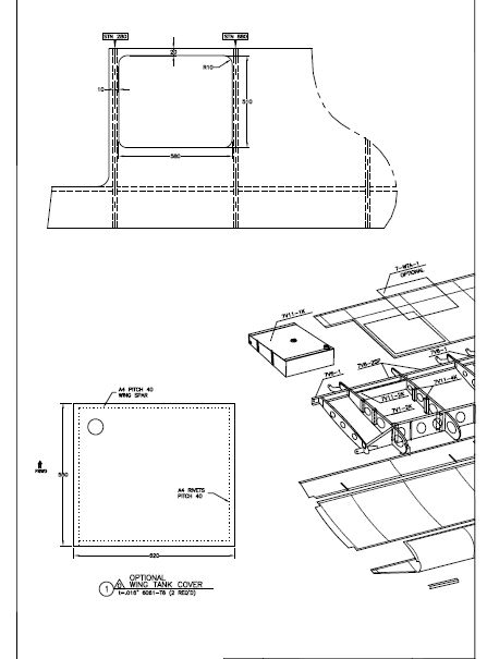

In didn't even check if this is still an option. It was emailed to me. But here is what I have.
Kevin

The wing tank access cover shown in the plans is what I am planning on doing with my wings. I see no problem with using a cover as shown. And it beats removing the whole top skin or half of a top skin to get at the tanks if necessary.
Bryan Ekholm

This is not even shown in my plans, someone emailed me the above pic. I guess my question is can it be made for dual tanks too. I did yesterday on the Zenith builder site see that Ken P has dual tanks and a big opening in the skin, so presumably a big single cover.
Kevin

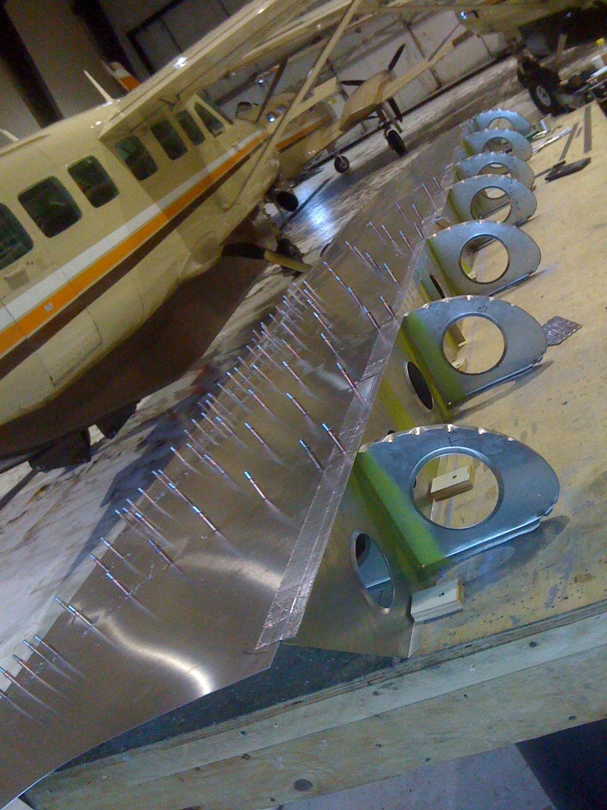

Her it is, my apologies to Ken for posting with out permission.
Kevin

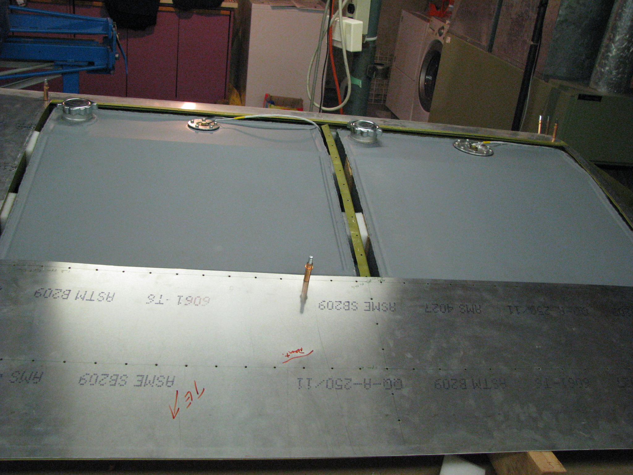

Just split the skin (lap joint) at the rib outboard of where the aux. tank goes that way you have one section of wing skin that can be removed that will expose both tanks and pluming behind the tank support and the plumbing at the main tank..... fuel leaks are a pita and there is no better insurance than easy access in my opinion
lap joint at last row of clecos
