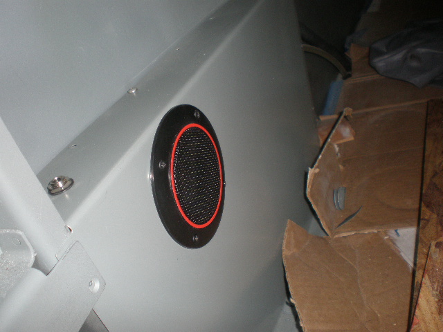

I got an inexpensive one at Fry's Electronics in Calif. - There, you can also get a nice durable and inexpensive grill to cover the speaker.
There is a specific OHM requirement which is probably in the manual for the audio panel. I cut a hole in the side panel at hip level in the right side of the back seat. Seems to work fine, but with all the excellent headsets out there - not sure it is really needed.
