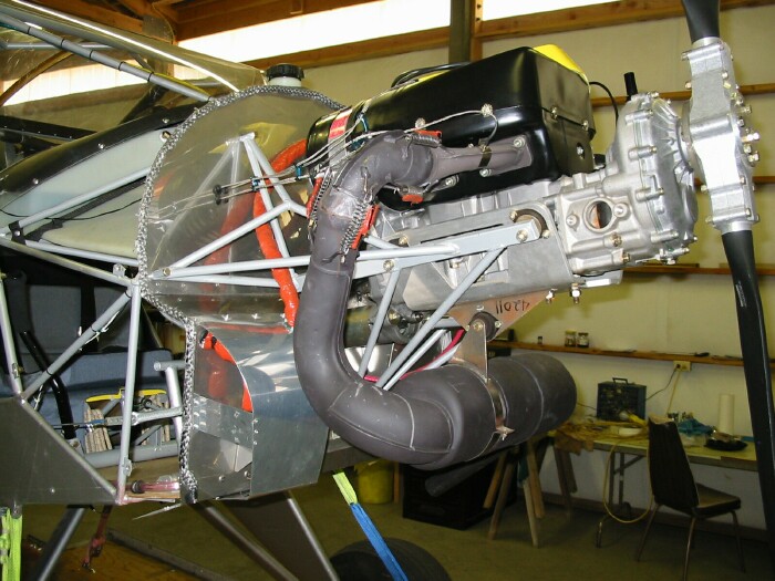

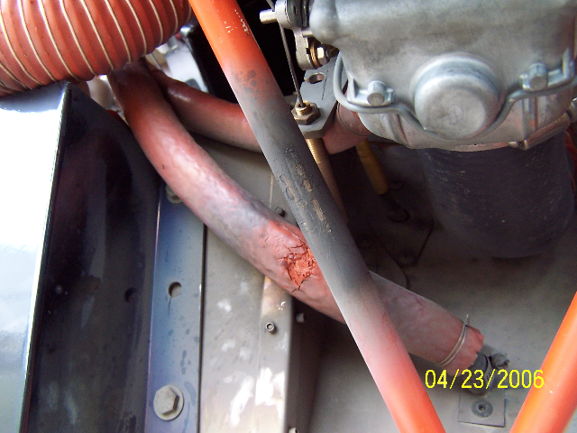

If you think fire sleeve is ugly, think what this scene would have
looked like if I DIDN'T have the fire sleeve in place. The flames
which resulted from a broken off tail pipe were hot enough to blister
the motor mount paint, char the fire sleeve, sneak around the battery
box and melt a hole in the battery, and let the electrolyte out of
one cell.
Even before this happened, I thought the fire sleeve was cool-
looking. I now think it's even cooler!
p.s. There was an aluminum heat shield in place between the muffler
and the carb....it is now made from stainless steel and it's bigger.
Any future exhaust flames will find it a bit more difficult to get
near the fuel lines or my Rotec TBI fuel-metering device...the Bing
is gone.

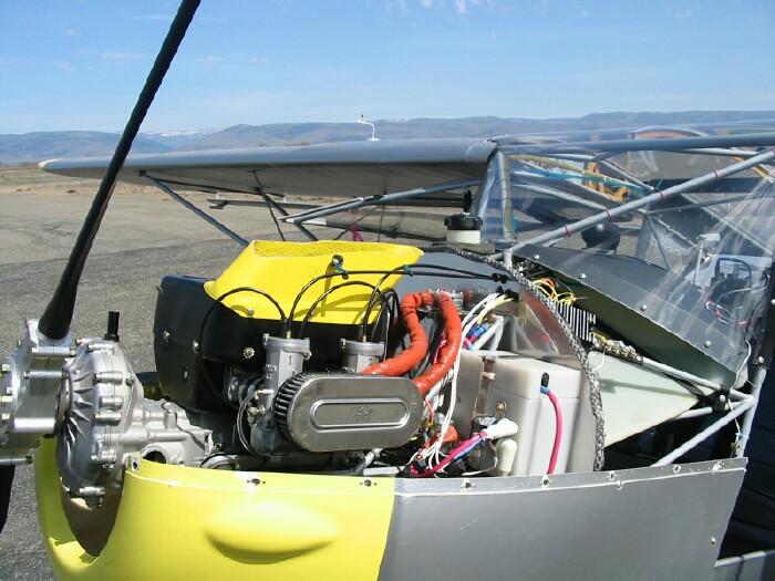

I installed fire sleeve on the fuel lines forward of the fire wall. It came with the kit. I like the idea of just keeping heat off the lines in general as well as the flames incase of fire.
Prices are by the foot. http://www.aircraftspruce.com/catalog/appages/aqfiresleeve.php
