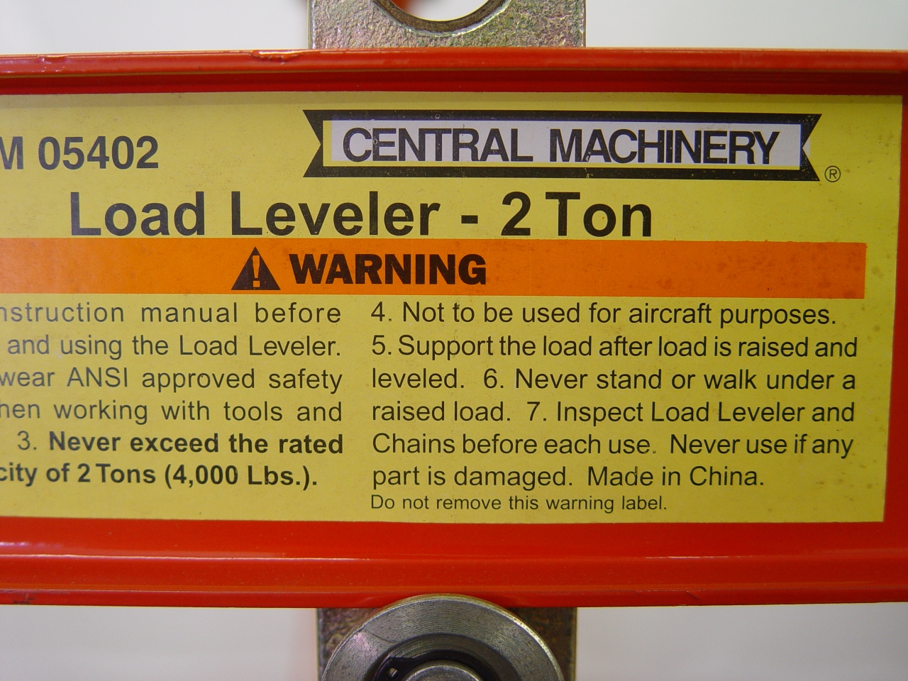

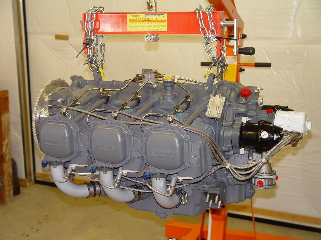

I used the final mounting bolts. Very easy. Just don't try it with
the prop on it.
I used the 2 ton harbor freight hoist for <130$ on sale plus the load
leveler. Their smaller hoist would work too. You know you have the
right setup when you get this kind of warning (see photo). I too would
suggest buying one if feasible. The HF hoist folds up to take very
little horizontal space. It's great for mounting/demounting the prop
and avoiding another rental.
I left the engine suspended (with safeties) for about 6 months at one
point. That appeared to damage the jack and had to replace it for a few
more $$$. So rentals can make sense.
