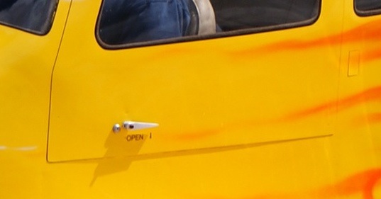

Here is an air to air pic + enlargement.
Speed was only about 110 knts max as the photo ship was a C182.
On the ground the door is perfectly flush all around, with no visible
bulge at the leading edge, nor at the bottom.
In flight I have not noticed it moving out, but we have a thick lining
material there. But the bulge is definitely visible in these pics. Our
pins go right into the frame as per Vans instructions, but it serves
as a reminder to ensure that the front pins have plenty of engagement.
We also have the Vans door warning system and that hasn't illumintated
in flight.
Nor is there any feeling of a draught at all, so the seals obviously
do their job well.
Neil

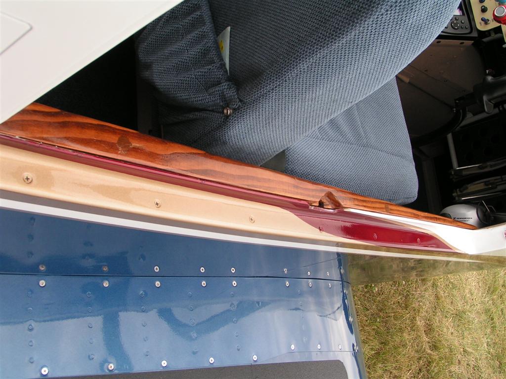

Here it is.
Chris

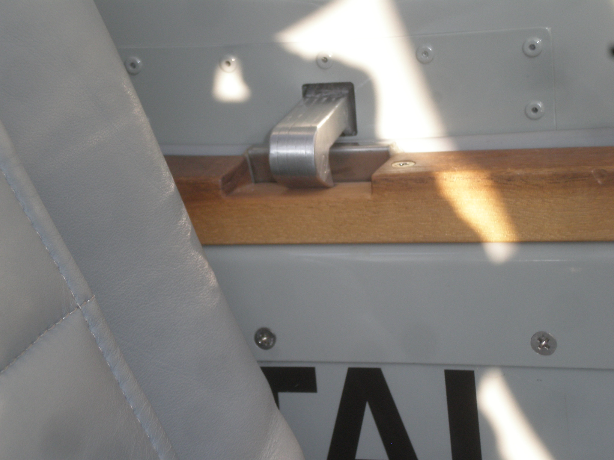

N220RV - the factory Continental equipped RV10 has a nice latch system. I do not know when it was installed but it is a spring loaded mid door latch

Is this Van's answer to their door design? I think they should make this modification available to all builders as a standard build item. Has anyone talked with Van's about this mod?
Rick

Does anyone have a pix of the N220RV mid door latch? I'd like to see how
Van's handled this issue.
