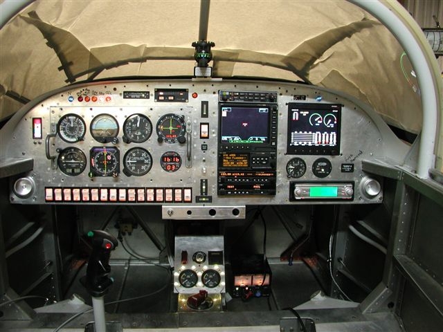

I had QB tanks on my 6A and put a fitting in the side forward of the fuel guage sender
all the way in to the second bay. Wasn't a big deal at all.
When I got my duplex valve, I didn't know about the gozillion configurations and would
have ordered it with -4 fittings for the purge lines and plumbed it back to the tank that
way - had I known. I got the one that has all(6) AN6 fittlngs - I don't have the part
number - but like I said, I would have done one set of AN6 and one set of AN4 had I
known.
My FI is from AFP and the line from the servo to the purge valve, spider, and back to
the valve is a -4. It converts to a -6 line right before the valve. Check your FI
system - you might be able to simplify yours like I could have.....
BTW, I oriented my valve such that it points to the left fuel guage when drawing from
the left tank and points to the right fuel guage when drawing from the right tank. It
was a PITB to put together - but real simple in flight.
I attached a photo - during construction - hope it isn't stripped off. More pics if you
want.
Ralph
