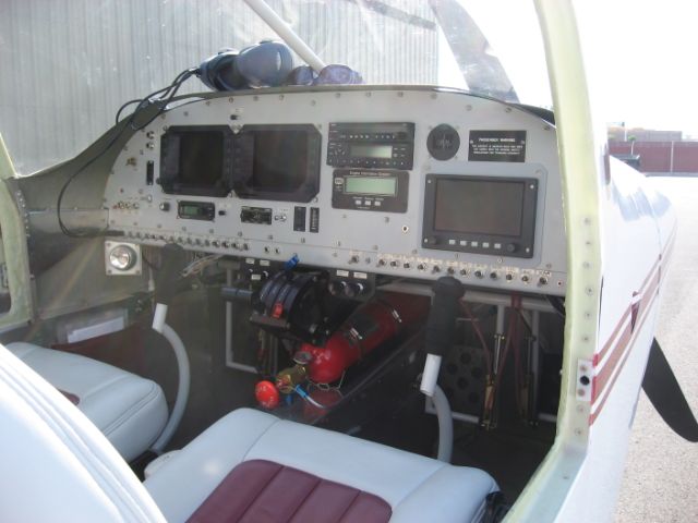

PostPosted: Thu Sep 10, 2009 6:19 pm    Post subject: Info and Question on Van's FWF Kit (including hoses) Reply with quote
Another option is a fire bottle , dumping Halon for and aft of the baffling
at pilot activation.
SEE http://www.stroudsafety.com/HalonSystems.html

Am I missing something? Just cut off the fuel. The fire should go out without fuel.
John
tsts4
Joined: 06 Aug 2007
Posts: 167
Location: Tampa, FL
PostPosted: Fri Sep 11, 2009 5:01 am    Post subject: Re: Info and Question on Van's FWF Kit (including hoses) Reply with quote
Just to play devil's advocate, what if you can't shut the fuel off--you're knocked out or something. Hypothetically, having maximum protection FWF might buy you or some bystander time to extract you from the cabin before getting cooked.
Todd Stovall
aka "Auburntsts" on EAA and VAF
RV-10 N728TT -- Flying
dlm46007(at)cox.net
PostPosted: Fri Sep 11, 2009 7:20 am    Post subject: Info and Question on Van's FWF Kit (including hoses) Reply with quote
If the fuel cannot be shutoff then the fire is already in the tunnel. An
Andair fuel selector turned off should stop feeding the flames and a fire
bottle ought to cool everything ; without oxygen the fire should be
suppressed. Race cars are required to have fire suppression systems and are
more susceptible to fires than our aircraft. In addition Part 21 aircraft
are required to have fire detection and fire suppression systems. Check the
Boeings. My A&P course had an extensive class on fire detection/fire
suppression systems for Part 21 aircraft. My Glastar has a temperature
sensor in the Carburetor box and inlet spray and a spray nozzle over the
cylinders. The 10 has a sprayer on top of the cylinders and another between
the firewall and the rear baffling.
gengrumpy(at)aol.com
PostPosted: Fri Sep 11, 2009 8:50 am    Post subject: Info and Question on Van's FWF Kit (including hoses) Reply with quote
Another alternative is a small, spring loaded door in the top of the
tunnel just forward of the fuel valve.
Poke the nozzle of on-board extinguisher through the opening and let
'er rip.
$64 question is whether or not to use halon or the standard gasoline
ABC extinguisher.
Halon will kill you dead as a door nail if you breathe it.
grumpy

dlm46007(at)cox.net
PostPosted: Fri Sep 11, 2009 9:43 am    Post subject: Info and Question on Van's FWF Kit (including hoses) Reply with quote
Mine is Halon but the gas goes forward of the firewall. You definetly do not
want to discharge Halon in the cabin without a lot of air flow in and out.
rv10builder(at)verizon.ne
PostPosted: Fri Sep 11, 2009 11:35 am    Post subject: Info and Question on Van's FWF Kit (including hoses) Reply with quote
Aviation consumer news did a report on this. Basically Halon is your best
option. ABC extinguisher will ultimately cause more damage than Halon.
They note about inhaling Halon- "The FAA notes- The toxic effects of a
typical aircraft seat fire, for example, far outweigh the potential toxic
effects of discharging a Halon fire extinquisher". I take away two things
from this- don't allow smoking in the plane, and if the seat is on fire to
care what Halon will do.. all joking aside.. the point really is that one
wants to keep the fire out of the cabin, smoke alone will do far more than
anything the Halon could do.. one can spray a little on a smaller fire and
use vents to get air, but with smoke from a fire there is no only inhaling a
little bit. This goes back to my seconding that having Stainless steel for
a vent is a great option. If the fire goes through the weakest link, SS vent
or RTV than the smoke will hit you probably before any fire, but if you have
a cheap aluminum vent the fire may very well start coming in and burning
everything on the cabin side than cause lots of smoke- "everything" since
the vents go forward and back in the cabin.
There really isn't any great option when one has a fire, but it sure helps
to keep any openings sealed as best as possible. There is the discussion
about "must have" firesleeves on the hoses that runs another $200 plus above
the stock Van's hoses, if one is going to go to that extent, spend the $100
and do your best to keep the fire out a few seconds more.. it really could
be the difference between you talking about it or everyone else talking
about it in your memory..
So what did ACS say about the Halon? since that was the question- basically
ABC (dry-chemical) have too much to be desired among the issues-
vision-limiting and respiratory effects.
They conclude with "on a really bad day you have one, however, you'll want
to reach for a Halon extinquisher while aiming for the nearest runway."
Referenced December 2008 edition.
Pascal
From: "Miller John" <gengrumpy(at)aol.com>
Sent: Friday, September 11, 2009 9:47 AM
Subject: Re: Re: Info and Question on Van's FWF Kit (including
hoses)
Poke the nozzle of on-board extinguisher through the opening and let 'er
rip.
$64 question is whether or not to use halon or the standard gasoline ABC
extinguisher.
grumpy
> fire
> are
> aircraft
> the
> between
dlm46007(at)cox.net
