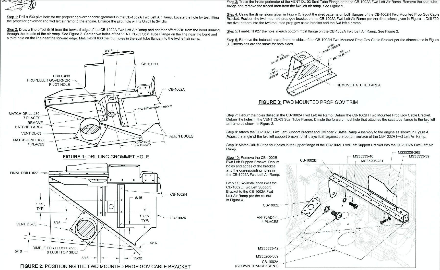

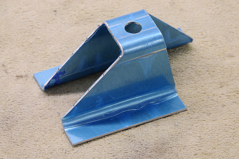

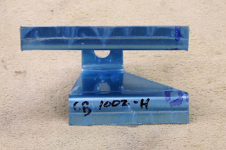

Dear Listers,
Van's turned me on to a bracket for the RV-10 called the CB-1002-H which is a bracket for mounting the governor control cable on front mounted governors.
Does anyone have some good pictures of how this bracket is installed? Maybe even a scan of the baffling installation OP sheet where the RV-10 baffling is described?
Since the IO-390 has a front mounted governor similar to the IO-540 used on the RV-10, some of these baffling pieces seem to work.
Any docs you could provide would be most appreciated!

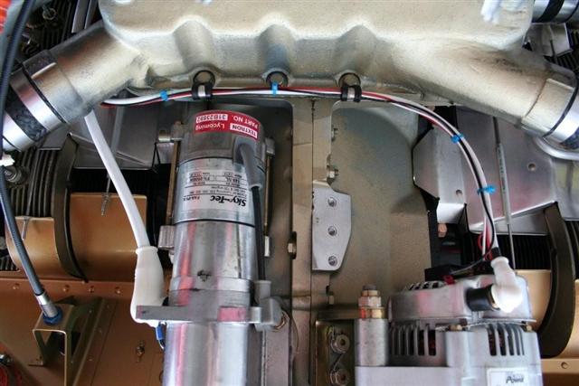

Matt,
See if this helps.
Lenny
 Filesize:  420.27 KB

PostPosted: Fri Sep 18, 2009 8:48 pm    Post subject: CB-1002-H Governor Bracket Installation Photos...? Reply with quote
Hope this helps...lower left of the photo.
