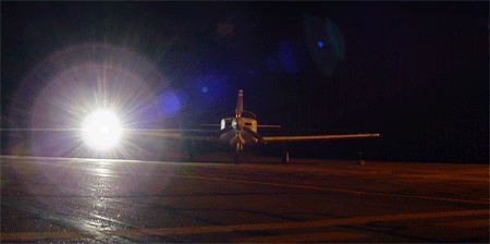

  In the past I have mentioned that a number of pilots have said how bright & noticeable my Dual Wig Wag HID lights are from the ground when I am on approach during the daylight hours. This is exactly what I wanted from the first day I saw my neighbor’s Pilatus swoop into our home field with his flashing HID’s a blazing. I think the little boy inside of me said… “me want.”
  Well yesterday on a dusk flight departing the LA basin ATC called traffic “South West 737 you have RV-10 Traffic 10 O’clock, 17 miles 8,500 feet. November 110EE traffic 2:00 O’clock descending out of one-one-thousand feet a Boeing 737.” Before I could respond the South West 737 replied Traffic Insight. Moments later the SW pilot told me through the controller “that is some light system he has on his RV-10, it’s really easy to pick up” COOL! Getting “at a boy’s” from commercial pilots.
I consider the Wig-Wag HID’s to be an important safety feature on my -10. Seeing is avoiding.
  The set up is nothing out of the ordinary with the exception of dual 35W HID lights placed in the leading edge. If interested I have a page that shows the install. http://www.painttheweb.com/rv-10/Lights_LEDHID.htm . One more thing of note. When on that page you will also see some pretty expensive (but nice) LED Position Lights. My next build is an RV-8A and I have found a set of Red & Green LED bulbs for around $8.00 each including wired sockets (eBay). These appear to be an excellent and cost effective solution vs. the printed circuit board LED’s I used on my -10. Plus some significant time savings to install as well. I will report results once flying.

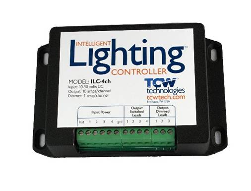

http://www.tcwtech.com/ILC-4ch.htm
http://www.xevision.com/hid_pulsing.html
Very important that the Wig/Wag has Warm Up Feature so HID does not pulse till fully warmed up (30 seconds or so).

Here's a site that has done something very simila regarding the nav lights light the ones you've shown. Here's his link. http://www.reiffpreheat.com/RV4.htm Scroll to the bottom to see his installed pics.
