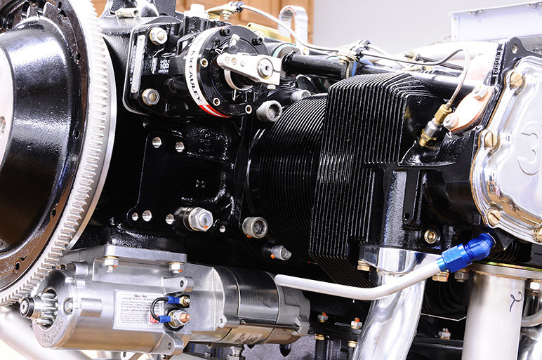

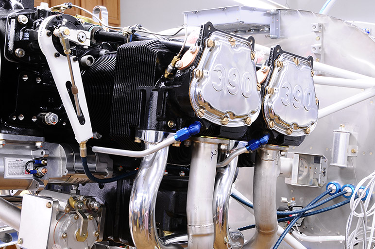

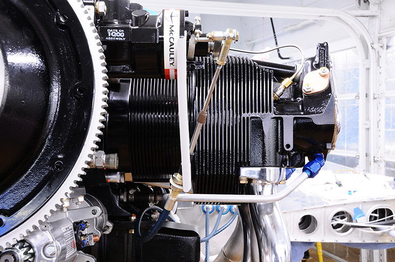

Hey, first I wanted to say thanks for the feedback on all my other questions!
So I ran the Governor cable today and it came out pretty nice and seems to work well. The only thing that seems a little 'if-y' is how I had to route the cable over the top of the oil sump. Is this SOP or should the cable be isolated from the sump some how? I guess I could make a standoff bracket to hold it up off the sump, but do I really need to? The cable is currently resting on the sump.
Thanks!

Hello Matt,
That's certainly doable, but will be very intrusive if you use Van's FAB
air box & filter assembly. There are several variations of the prop
governor, FAB air box, and front baffle posted on Marc Ausmen's site...
http://www.io-390.com/IO-390.com/Welcome.html
