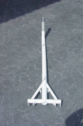

Looking at my untouched nose strut, I happened to notice a very subtle curve, or bend, to it. If you put a straight edge on it, it has a constant curve to the right. The gap between the straight edge and the tube is very small - only about 1/16", but it's definitely there.
Looking at the almost completed RV-10 next to me, the tube is straight. Perhaps weight takes it out? Anybody seen or heard of this?

Not sure if we're talking about the same part, but my nose gear had a curve in it. It was off by 3/16" in the middle. I contacted Van's with pics and they sent a replacement. I did not have to send the old one back. It now resides in a scrap heap.
Van's told me they had a few of these that came out this way from the supplier and there was an occassional jig issue during welding.

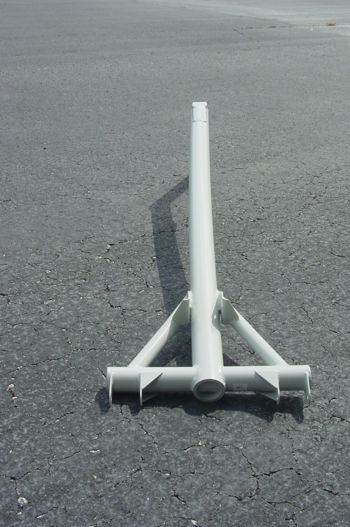

Here are two photos of mine.
John

I had a nose gear problem as well. It looked like the vertical portion of
the nose gear strut was welded about 4 degrees off. I contacted Vans with
photos with plumb bob and digital angle finder and they agreed and replaced
it.
