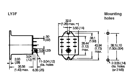

Hello Bob,
I want to add a little 3 pole relay to turn a Trutrak Flight Systems Automatic Pitch Trim on and off. (I did not consider this capability when I was running my wire bundle to the pitch servo area though I do have a spare pair that could be used to control a relay.)
Page 7 of the Trutrak manual has the wiring diagram for their Auto Trim module.
http://www.trutrakflightsystems.com/documents/AutomaticPitchTrim.pdf
Can you recommend a relay that might be carried by Allied Electronics? http://www.alliedelec.com/
I don’t think you sell such a critter.
Allied has a lot of choices. This one is suited
to your task:
http://www.alliedelec.com/Search/ProductDetail.aspx?SKU=8210912&MPN=LY3F-DC12
http://www.alliedelec.com/Images/Products/Datasheets/BM/OMRON_ELECTRONICS_LLC/821-0906.PDF

At 09:18 PM 8/15/2009, you wrote:
Hello Bob,
to your task:
