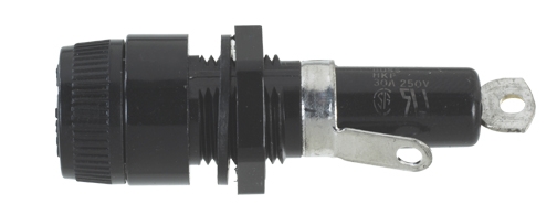

PostPosted: Wed Jul 15, 2009 12:50 pm    Post subject: D.A.R question about fuse access Reply with quote
At 11:39 AM 7/15/2009, you wrote:
I wonder how a DAR would look upon Vertical Power. No fuses. You have a control box in the panel that you can reset a "failed" circuit, but that's it. There's no ability to "change fuses in flight".
. . . but you can 'reset' a tripped circuit under software
control. One of the BIG arguments for breakers over fuses
was the ease of resetting and low risk for dropping a fuse
holder's cap . . .
[img]cid:.0[/img]
. . . not to mention relief from having to carry
spare fuses. The advantages are inarguable. Over the past
20+ years we've developed various tools for fault current
protection including remotely controlled circuit breakers
and sundry electronic fault detection and reaction systems.
The Eclipse 500 had no breakers in the cockpit but pilots

But getting back to simple ideas: Fuses/breakers/other are
intended to protect the airframe from hard faults that put
other systems if not the entire airframe at risk. Once
that fault occurs, the system is out of business. It's
a good idea to make the event known to the crew . . . but
resetting is 99.99% never useful or a good idea. It was
reported that repeated resets of the cabin heater breaker
on an airplane carrying Ricky Nelson may have figured in
the fire that brought the airplane down.
The prudent rule for tripped breakers and fuses (that are
sized to avoid nuisance trips) is leave them alone until on
the ground. Should it be that said breaker powers something
you really need . . . then so much for failure tolerance
(or perhaps even the decision to launch).
From my personal sense of elegant solutions, the idea
that replacing a perfectly good 25 cent fuse with hardware
that is larger, more expensive, higher parts count, and
perhaps driven by software does not make the airplane
cost less, assemble faster or perform better . . .
nor is it a positive return on investment.
( . . . a long habit of not thinking )
( a thing wrong, gives it a superficial )
( appearance of being right . . . )
( -Thomas Paine 1776- )
