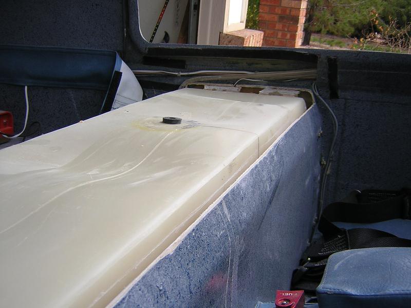

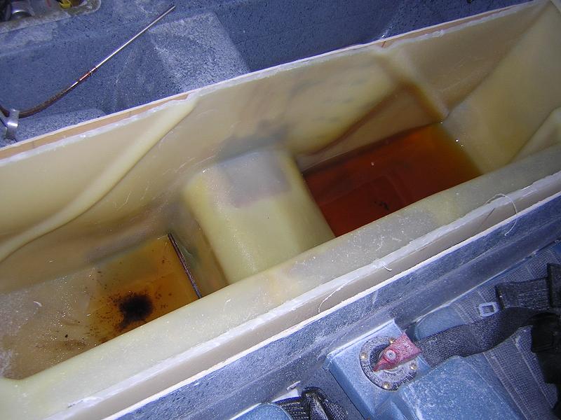

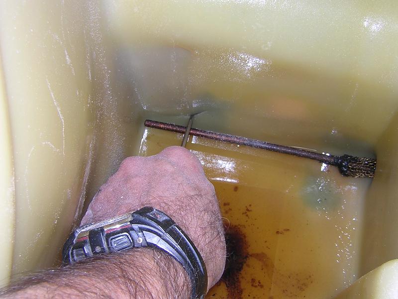

hagargs(at)earthlink.net
PostPosted: Mon Jul 13, 2009 8:11 pm    Post subject: Fuel Tank Leak Reply with quote
Jeff:;
My tank split in underneath the saddle area at an interface where I had a
fiberglass strap bonded in place. Take note when pulling the tank out you
will have most likely to cut it and take it out piece by piece. You will
also get an idea of how much these tanks bulge warp and other wise move
around. Which is why they get cracks in them. Kit car tank manufacturers
have known about this for decades and will not warrentee anything if it
is fiberglassed in!
