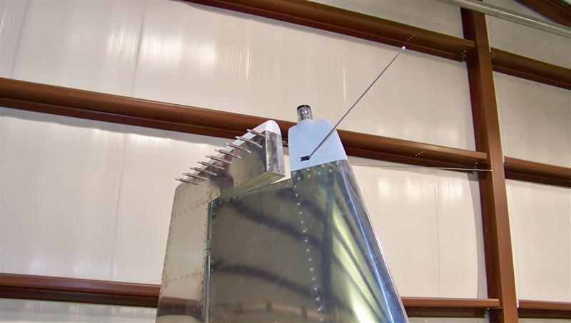

There are definitely some who've put it on top, under the
front fairing on the tip of the vertical stab. It
should work great there. Under the tail is working
well for me. It gives maybe 25% better range than
my wingtip Archer NAV, and that is facing the station.
If you face the wingtip away from the station it
can be much worse. I think the lower location may
be great for VOR signals since they'll be ground
based, but VS tip shouldn't be much different. It's
nice to get near 360 line of sight.

PostPosted: Wed Jul 08, 2009 8:17 am    Post subject: Nav antenna location Reply with quote
I've put my Comant Nav/VOR/GS V antennas there on both my RV-9A and my
RV-10. Seems to work great and no danger of running into the tips. I used
nutplates to make it easily removable.

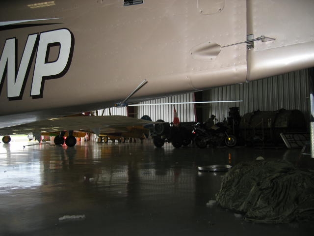

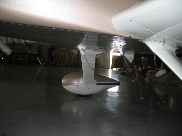

PostPosted: Wed Jul 08, 2009 9:19 am    Post subject: Re: Nav antenna location Reply with quote
Thank you for the quick replies.
I can see that the antenna will be protected by the horizontal stab and get better coverage (looking down) for the ground based signals. Sounds like the way to go. I saw an RV-10 in Memphis with the bottom mount. It looks like he just used bolts into nut plates on a reinforcing plate inside the fuselage. Is that how you've done it? I'll attach the pictures.
This plane also had two bent whip com antennas located between the main landing gear. What are your thoughts on that location??

PostPosted: Wed Jul 08, 2009 9:19 am    Post subject: Nav antenna location Reply with quote
One of the things I found out with the antenna on bottom is you can get shadowing if flying dirrectly to the station and Not very high (3000ft and below). So I'm in the mist of installing antenna on the VS. As the Comat man said, the bottom mount was the second best location.

PostPosted: Wed Jul 08, 2009 10:05 am    Post subject: Nav antenna location Reply with quote
I've got the dual com antennae on the belly and have no problems. Work
well. I can get your some pics of the doublers if you desire. I put
one of the Bob Archer VOR ant in the wingtip. I didn't want another
outside antennae. My main reason was that I didn't plan on using VOR
navigation that much. It is a good back up and cross reference, but
most of the time the GPS (496 and 430 ) are the primary nav sources. I
know it all depends on your panel preferences, your experience and
usage. Just my 0.02 cents.
Dr Fred
N515FW.

PostPosted: Wed Jul 08, 2009 10:13 am    Post subject: Nav antenna location Reply with quote
Mine is located on bottom of fuselage mounted just fwd of leading edge
of vert stab. Put in a doubler plate if you mount it there as the
skin is too thin to support (had to reinforce mine after 50 hrs).
Otherwise, I'm happy with it there and it's pretty much hidden
underneath the horizontals.

PostPosted: Thu Jul 09, 2009 3:08 am    Post subject: Nav antenna location Reply with quote
Hi Bill,
Yes I put mine there and it works just fine. I considered putting it down on the bottom like many others have done but had concerns about reception but also my grandkids running around the hangar and getting impaled on it down there. My plane is white in that section and the antenna is white so it's really not that noticeable and I'm used to seeing it there from my other certified planes.
I don't think you need them but if you would want any photos of the mount location let me know.

We put ours on top of the VS, we also added an LED beacon up there. See attached...

Jason
I am going to do the same thing and will add the LED beacon. I was
wondering why you have the Antenna pointed forward. I would think going aft
would relieve a lot of stress on the antenna mount.
I am also going to place the Nav antenna on top of the VS they really work
best up there.
John G. Cumins
40864 EMP
dlm46007(at)cox.net
