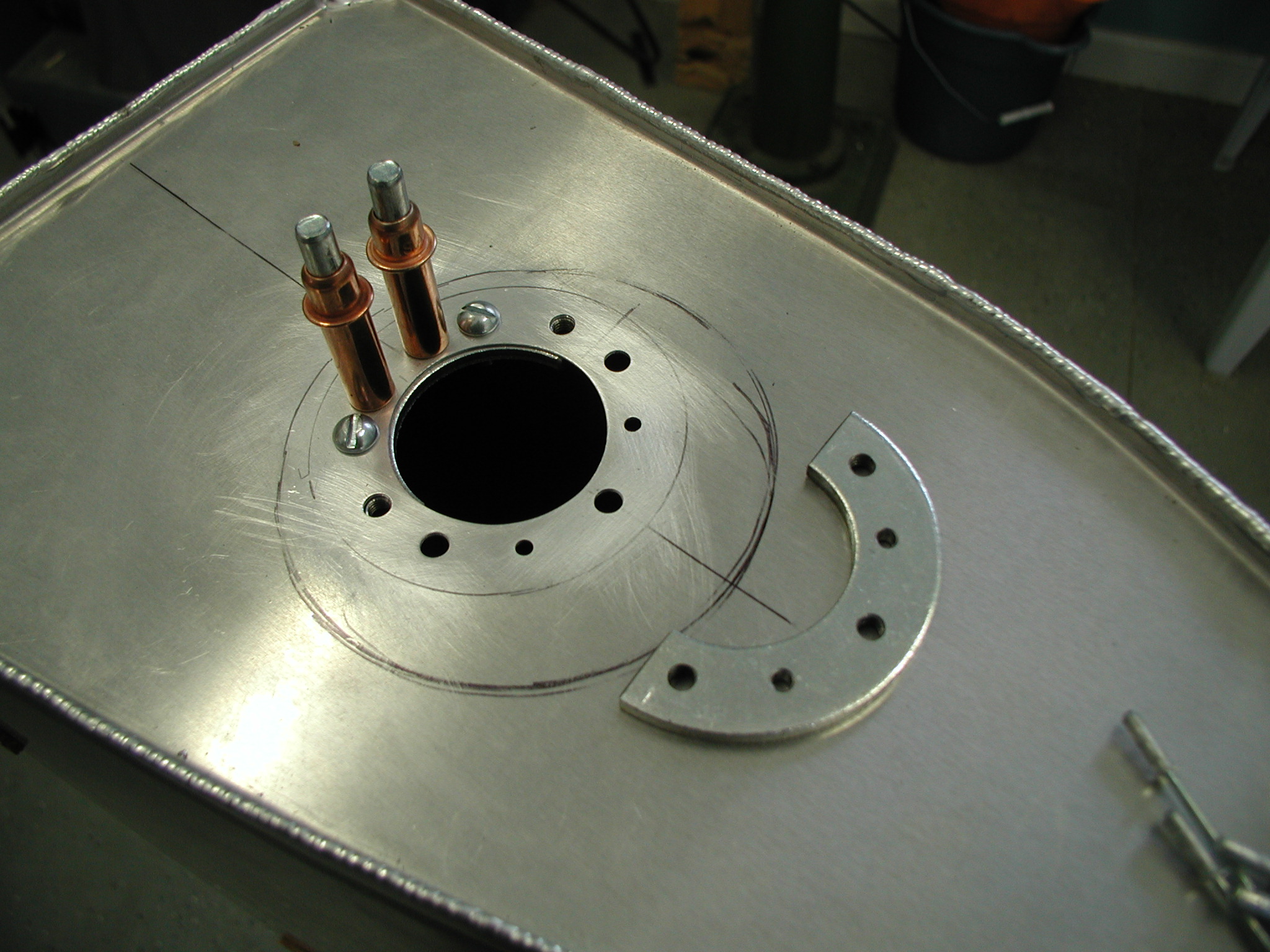

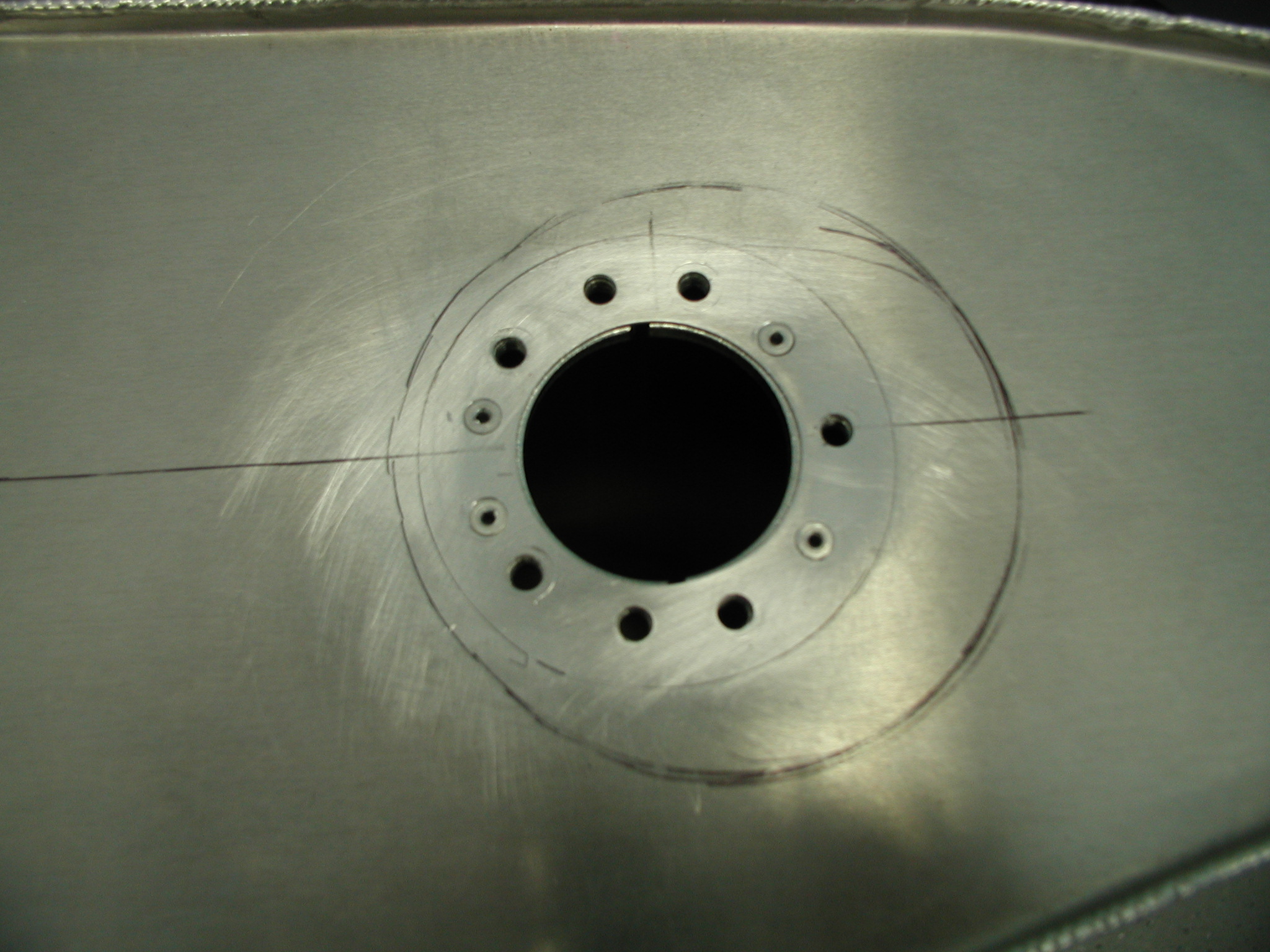

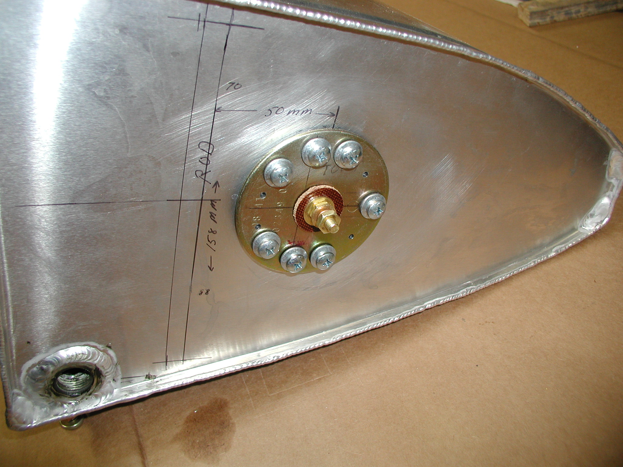

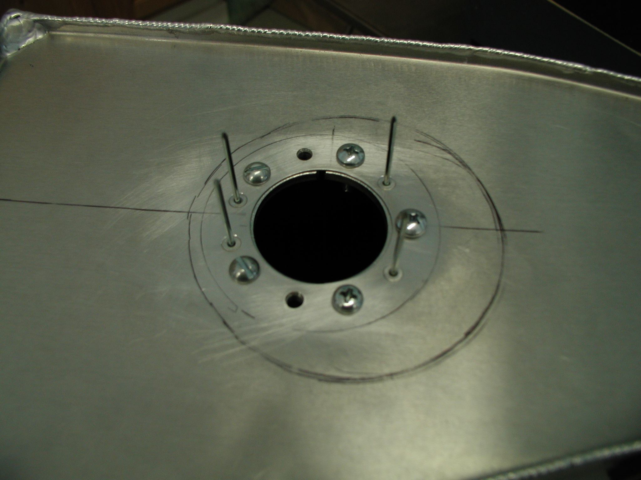

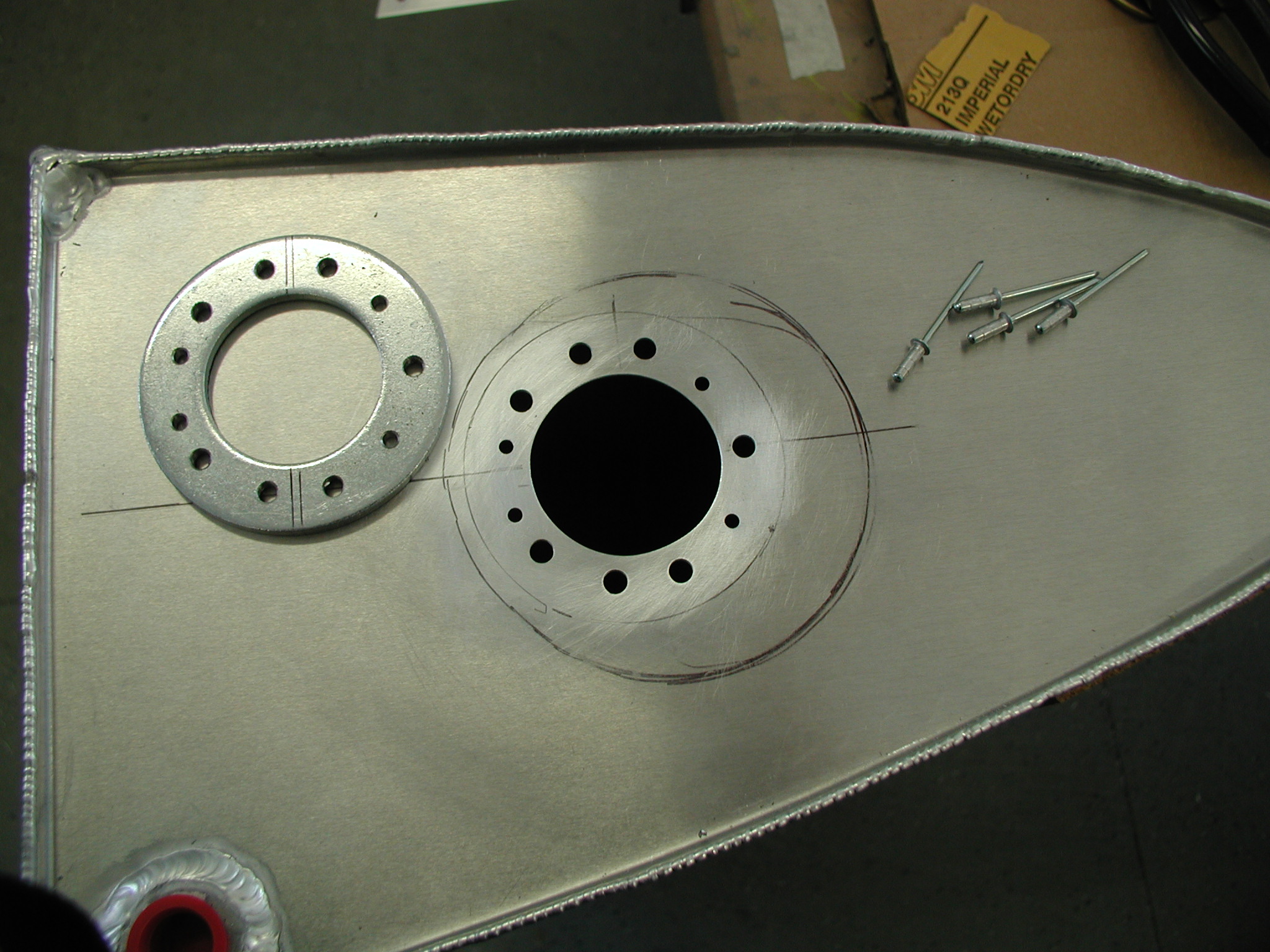

In my opinion the sender supplied with the kit needs some help. Get rid of the backing ring. It will only grab a very small amount of the tank skin.
Here are some photos. Also McMaster Carr has some very very good sealing washers for #10 screws. You will not need any liquid sealer.

On Tuesday 16 June 2009 19:31, John Davis wrote:
Hi Gary,
I installed my senders on the side per the plans. I first installed them
with just the gasket and paper washers for the screws and they leaked
around the screw holes. I removed them thu the lightening hole and the
maintenance opening on the bottom of the wing and and reinstalled them
with fuel lube sealant on the gasket and screws and haven't had a leak
so far. I've got about 15 hours with no leaks...
After sealing the sender with sealant as you did, I put a soapy mixture around
the sender, and pressurized the tank slightly.
On one tank, I got bubbles around one screw, and had to do some additional
sealing. On the other, no bubbles appeared.
I feel reasonably confident that when I finally get the aircraft finished I
won't have fuel leaks. Or at least, not there.
About 20 years ago, I rebuilt a Tripacer, and blindly thought with sealant and
snugging the screws to their appropriate level of tightness, thinking I
wouldn't have leaks. I was wrong.
