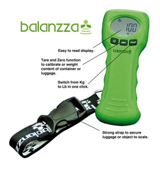

-10 List,
  I just purchased a hand scale to keep in my plane for weighing luggage etc… while on the road. It’s a nifty little device that seems to work pretty well based on a few trials. The item is called Balanzza http://www.balanzza.com/ I purchased the Balanzza Ergo. It lists for $24.95 but I think I picked it up (new) for $18.00 delivered on eBay. I even got one in a steel blue to match my plane. They have a new unit coming out called the Balanzza Too BZ300 that has a flashlight on the butt end but it’s closer to $40.00 delivered as it has not hit eBay/discounters.
Robin

That is WAY cool for the price and could probably also measure nosewheel breakout force!
Tim
