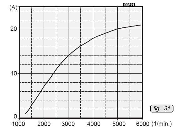

Not quite. That voltage level is too low. You need to
add up the real current draw for all accessories that
might be on at the same time. These cannot exceed
the rating of the alternator (assuming the battery
is charged) for the operating RPM . . .
[img]cid:.0[/img]
. . . and should not be more than 75% of that rating if
you want the alternator to replenish energy removed
before cruising flight RPMs are achieved.
The stock rectifier/regulator is marginal for the
way we use them. I wish they were a bit more robust.
It would add very little to the cost of the product.
John Deere has some single phase rectifier/regulators
rated in the 30A class. It would be interesting to
see how well these might substitute for the
stock regulator.
