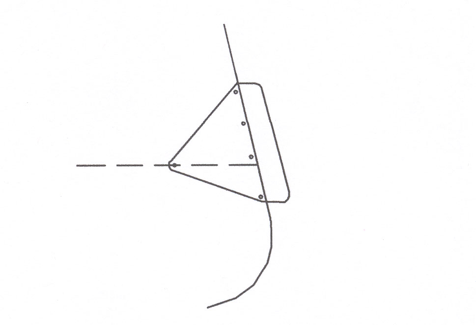

Greetings,
I have been reading the list here for a while, and want to take the opportunity to say thanks to all of you. I have a Series V with a Lycoming O-235 which is a great source of fun and unending lessons for me. There is one issue that I have, and that is that I must always input right rudder. I expect that at higher power settings, but at cruise? Anyway, I was wondering since the aircraft is already covered and flying is there some add-on type tab that I could affix to the rudder so that I don't have to constantly push on that right side. Cruise requires about 3-4 pounds or so of pressure. If someone has a photo or drawing, I would appreciate that too, as I am very visual. Thanks for any input.

Will,
I have been told by what I consider to be reliable sources that the engine
mounts designed for the Kitfox engines has no thrust offset - zero offset,
horizontal or vertical so right rudder is essentially built into the design.
I went through this for the first five years of flight on my Model IV and
had difficulty even considering a trim tab simply because it would look like
a bandage. I finally did the deed and it made a world of difference, not
only in cruise, but in the pattern as well. I hated right traffic patterns
because I had real problems coordinating the right rudder pedal with a right
turn. Everything just improved in bunches.
My airplane is gone, but the trim tab was about six inches top to bottom and
extended aft about an inch and a half or so. Overall it was triangular in
shape with a trimmed base so it riveted to the trailing edge and the rib
forward to prevent the trailing edge rivets from working as I adjusted it.
My ribs were of the Speedster style with an airfoil on the horizontal so
what I did there is drill through the rib and using a 4-40 blind nut from a
hobby store on one side and a screw of trimmed length inserted through the
tab. If you don't have the ribs in the rudder, I suppose you could go
through the fabric a bit oversizes and then use a tubular spacer of the
right length to accommodate the space between the 3/8" rib and the fabric,
though that might not be necessary that far back. I couldn't find any clear
photos, so made a drawing. As I recall, I bent the edges of the triangular
portion inward a little bit to create a firm contact with the fabric to
prevent air getting under and possibly lifting the tab.
Lowell

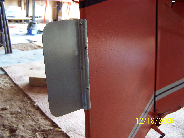

Here is a shot of my present trim tab, soon to be modified with a
servo from the model airplane world, and a controller. The tab looks
larger than it actually is, and I may be shrinking it further. I
staggered the rivets so that it would be more stable, and I attached
it with aluminum rivets so I could "drill it off" when the time came
to hinge it for the servo application. Also, I have since painted it,
so it is a little less obtrusive than it appears.
Lynn Matteson
Jabiru 2200, #2062, 654 hrs
Sensenich 62x46 Wood prop
Status: flying

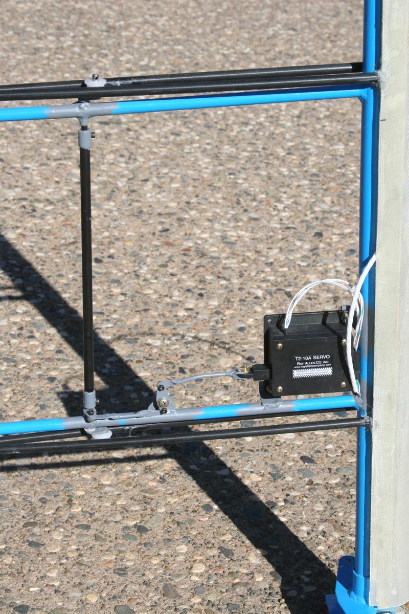

I guess this is as good a time as any to present my rudder trim system. I
have a servo in the rudder that will warp the two bottom ribs giving a
different cambered surface on one side or the other. The ribs are tied
together so I will get an overcamber and undercamber on a desired side, or a
symmetric surface on both sides controllable with a switch in the cockpit.
Of course it has yet to fly, but it is something I have been thinking about
long before the opportunity to build again came up.
Lowell

I am presently working on a controllable trim tab just like Bruce
Lina's. In fact, I just received the same controller that Bruce used
in his design. Now I'm working on a way to mount the servo...a model
airplane, giant scale servo...into the rudder, and make it secure.
Then I'll worry about running the wire through the fuselage. I've
already got the controller mounting bracket ready to attach to the
panel.....damn! I couldn't find room on the panel itself that was
convenient for the mounting and reaching, so I had to attach it below
and next to the choke, throttle and carb heat bracket. It is very
reachable there, and better than on the console, I believe. This is
the first time that I've had to add something to the plane that
didn't fit into the panel. I'd better run out of ideas pretty soon,
because I've already run out of room. : )

The nicest installation I have seen so far is posted on the
teamkitfox web site by Bruce, who goes by Airlina. It utilizes a
servo connected to a tab. Additionally, he has a two speed switch
for the elevator trim. Really, really nice work. My favorite idea
