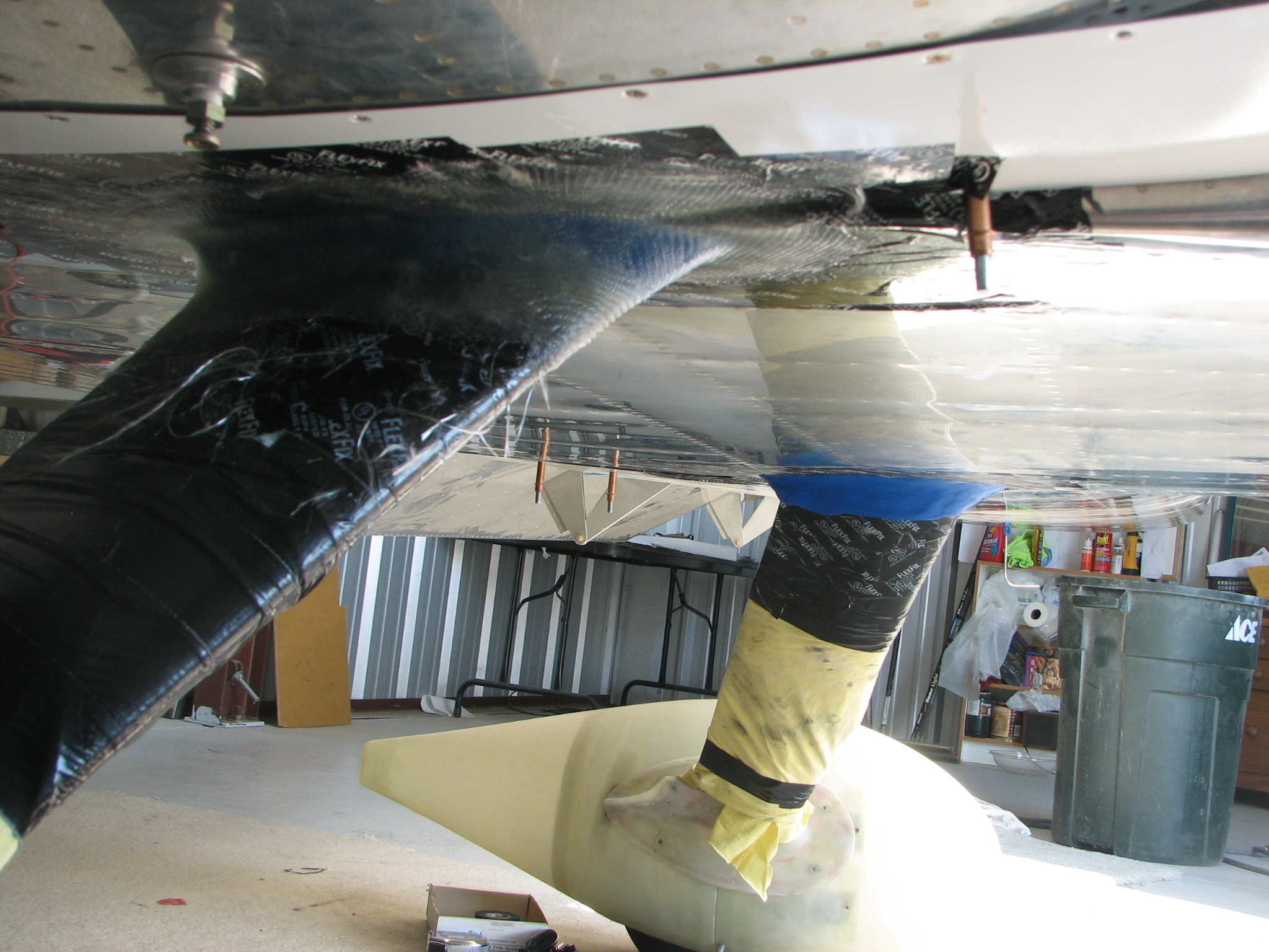

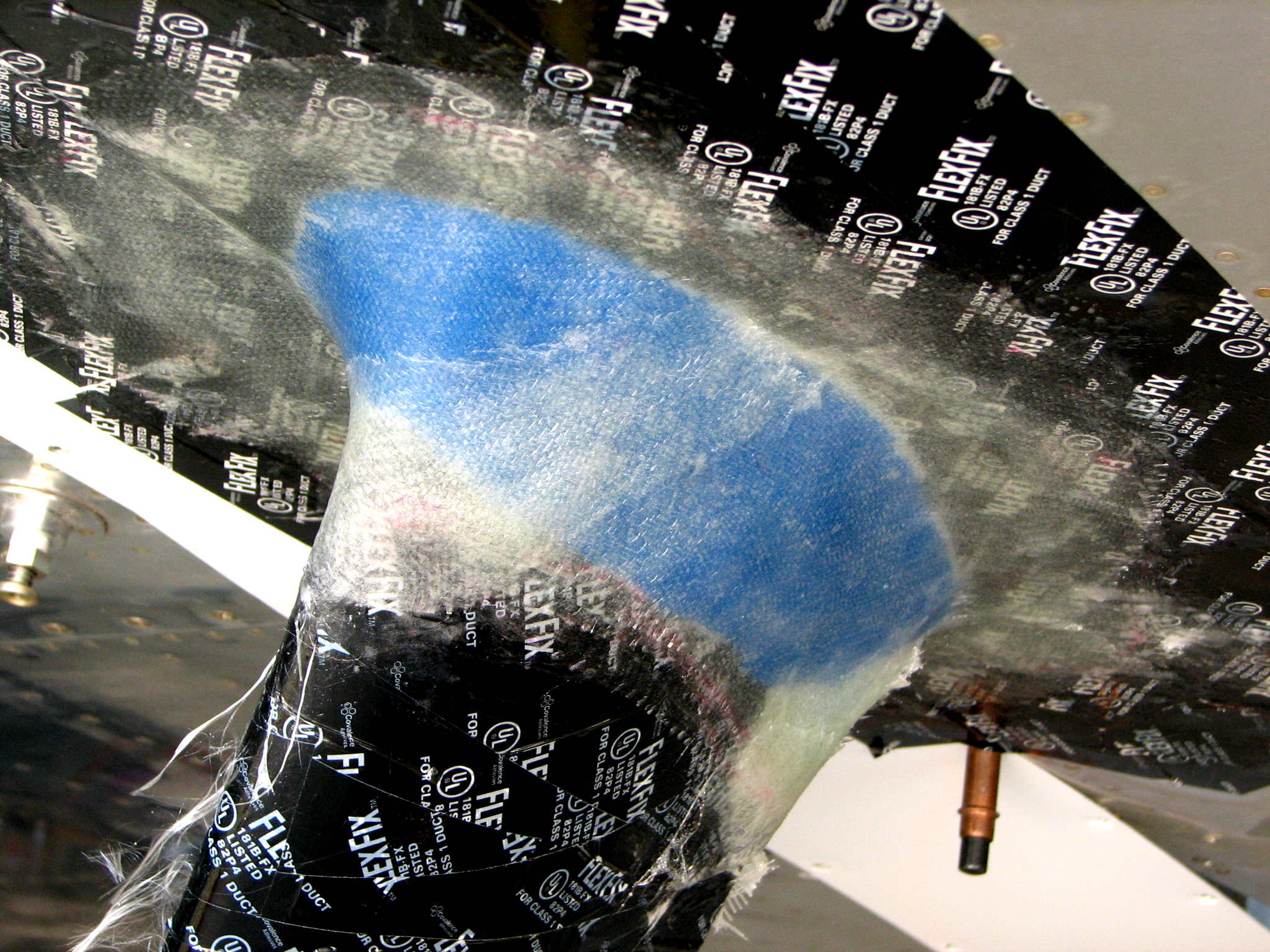

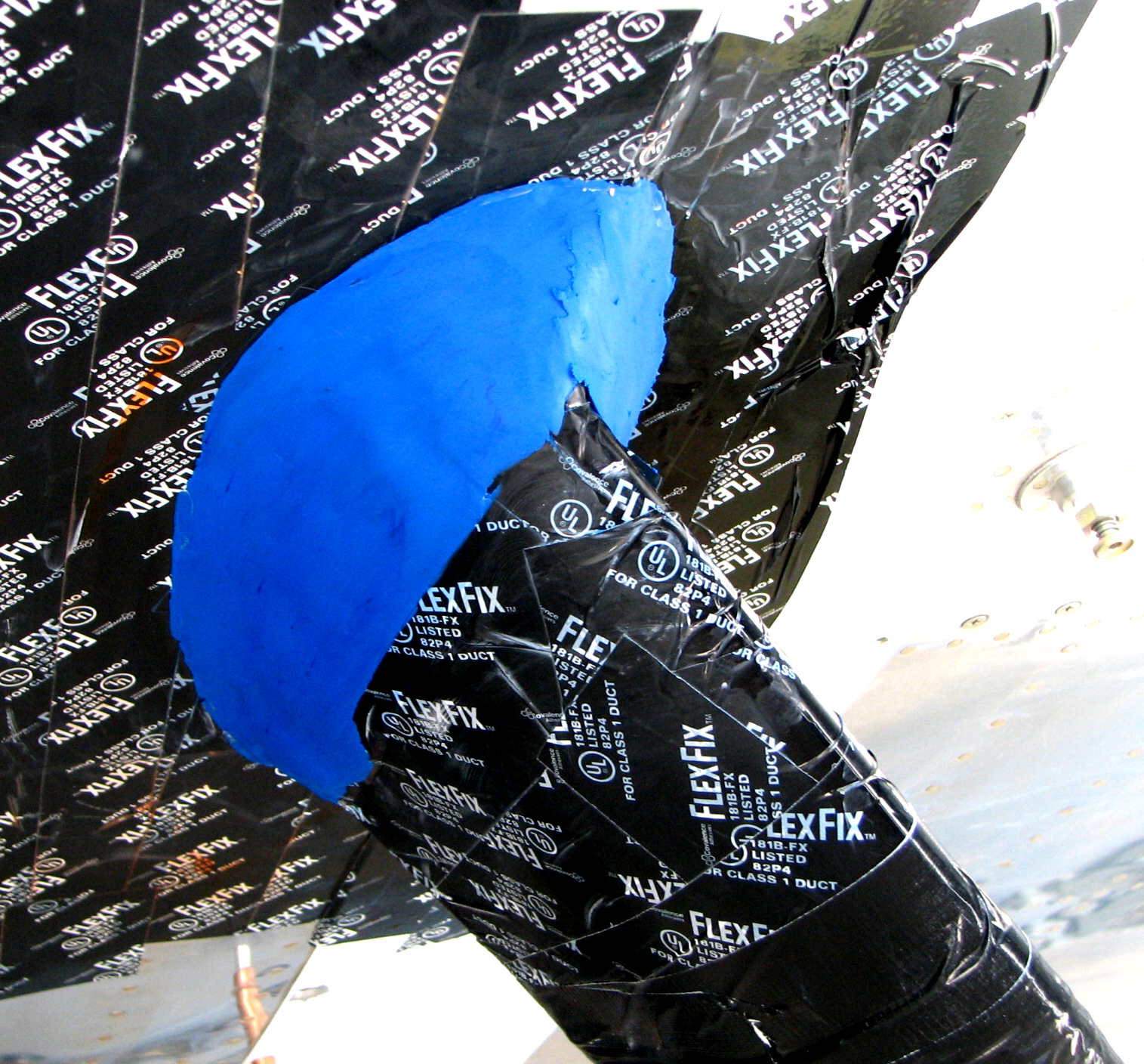

PostPosted: Fri May 15, 2009 9:40 pm    Post subject: Upper intersection leg fairing Reply with quote
I didn't like the way the Van's uppers fit, so we built our own.
Make sure you max the tape prior to applying the glass.

PostPosted: Fri May 15, 2009 10:39 pm    Post subject: Re: Upper intersection leg fairing Reply with quote
Hi Don,
what is the name of the blue stuff that you used to model the fairing with?
Michael

PostPosted: Sat May 16, 2009 5:33 am    Post subject: Upper intersection leg fairing Reply with quote
Clay...... wife bought it at Michael's.  Easy to form, not as easy to get it all off.... but that doesn't matter much.... after you get off what you can, use a heat gun.... but don't burn the glass.... it kind of rolls right off.

PostPosted: Sat May 16, 2009 8:50 am    Post subject: Upper intersection leg fairing Reply with quote
You can also get blue foam insulation from Lowes or other building
supply places. My Home Depot didn't have it. It's messy, but I think
it'll dissolve with gasoline.
