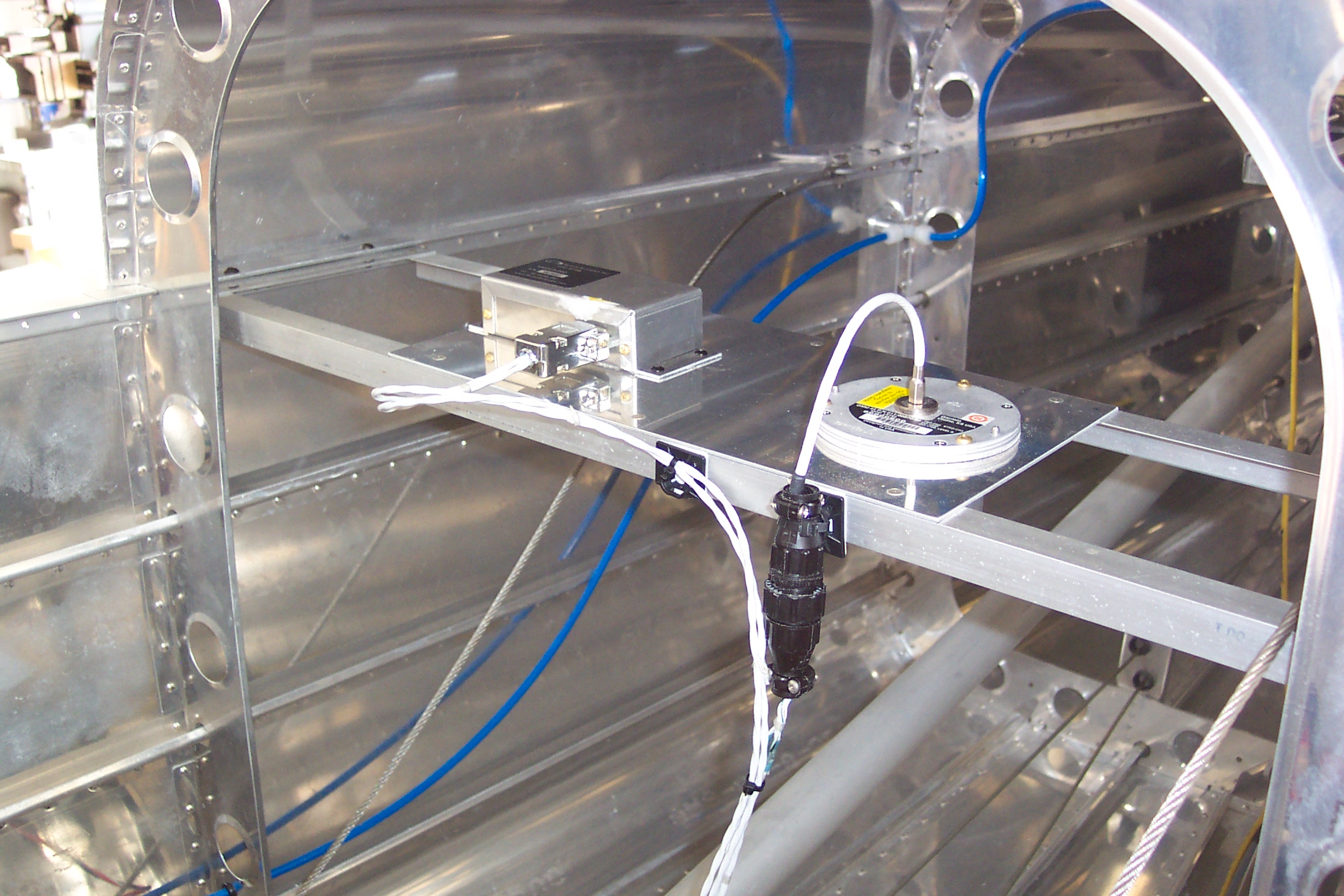

Does anyone have pictures of where they installed the AHRS and remote compass for a G900X system?

PostPosted: Tue May 05, 2009 9:15 pm    Post subject: G900X AHRS & remote compass Reply with quote
Does this help?
Robin

vhicy(at)bigpond.com
PostPosted: Tue May 05, 2009 9:51 pm    Post subject: G900X AHRS & remote compass Reply with quote
Robin my only concern would be the harness atach cables. We installed our unit at the top of the baulkhead to get away from them

robin1(at)mrmoisture.com
PostPosted: Tue May 05, 2009 10:49 pm    Post subject: G900X AHRS & remote compass Reply with quote
Stainless Steel hardware.
Every problem has a solution, just add dollars.
If this was not S/S they definitely will interfere with the electronics. You may still have to do the same. These are really sensitive devices.

PostPosted: Tue May 05, 2009 11:19 pm    Post subject: G900X AHRS & remote compass Reply with quote
You know I reckon that may be the problem with my installation as well – where do you get the stainless steel harness attach cables? (My AHRS/Mag tray is in almost the same position).

PostPosted: Wed May 06, 2009 4:20 am    Post subject: G900X AHRS & remote compass Reply with quote
I followed the recommendation from Garmin and put the AHRS on the mount from Van and the Magnitromiter in the tail like they picture in the manual.
It works great

PostPosted: Wed May 06, 2009 4:23 am    Post subject: G900X AHRS & remote compass Reply with quote
Nice picture! Thinking more about the electronic slip indicator .....
what's it do sitting still on the ground??? The other post about the
AHRS being out of cal makes sense. If it's accurate on the ground ....
or taxiing straight and out in flight I think points to a true slip.
Linn

PostPosted: Wed May 06, 2009 7:54 am    Post subject: G900X AHRS & remote compass Reply with quote
The harness attach cables haven't really been a big problem in the RV-10's with the G900X Remote Mag in that area, but the attach bolts usually are. If either one of them causes an issue anyway, you can usually just degauss it....at least that's been our experience with lots of these RV10's with G900X's in them. Chris's solution isn't a bad one either, you just need to make sure it's fairly robust as well.
Cheers,

PostPosted: Wed May 06, 2009 8:44 am    Post subject: G900X AHRS & remote compass Reply with quote
Although mine isn't a G900X, the same theory applies and I
haven't seen a problem after the system is calibrated. You
can move the cables all you want and nothing changes. I
did use Brass hardware to mount the units though. But
used standard hardware on the cable ends. A good calibration
helps get rid of the iron effects on some systems.
