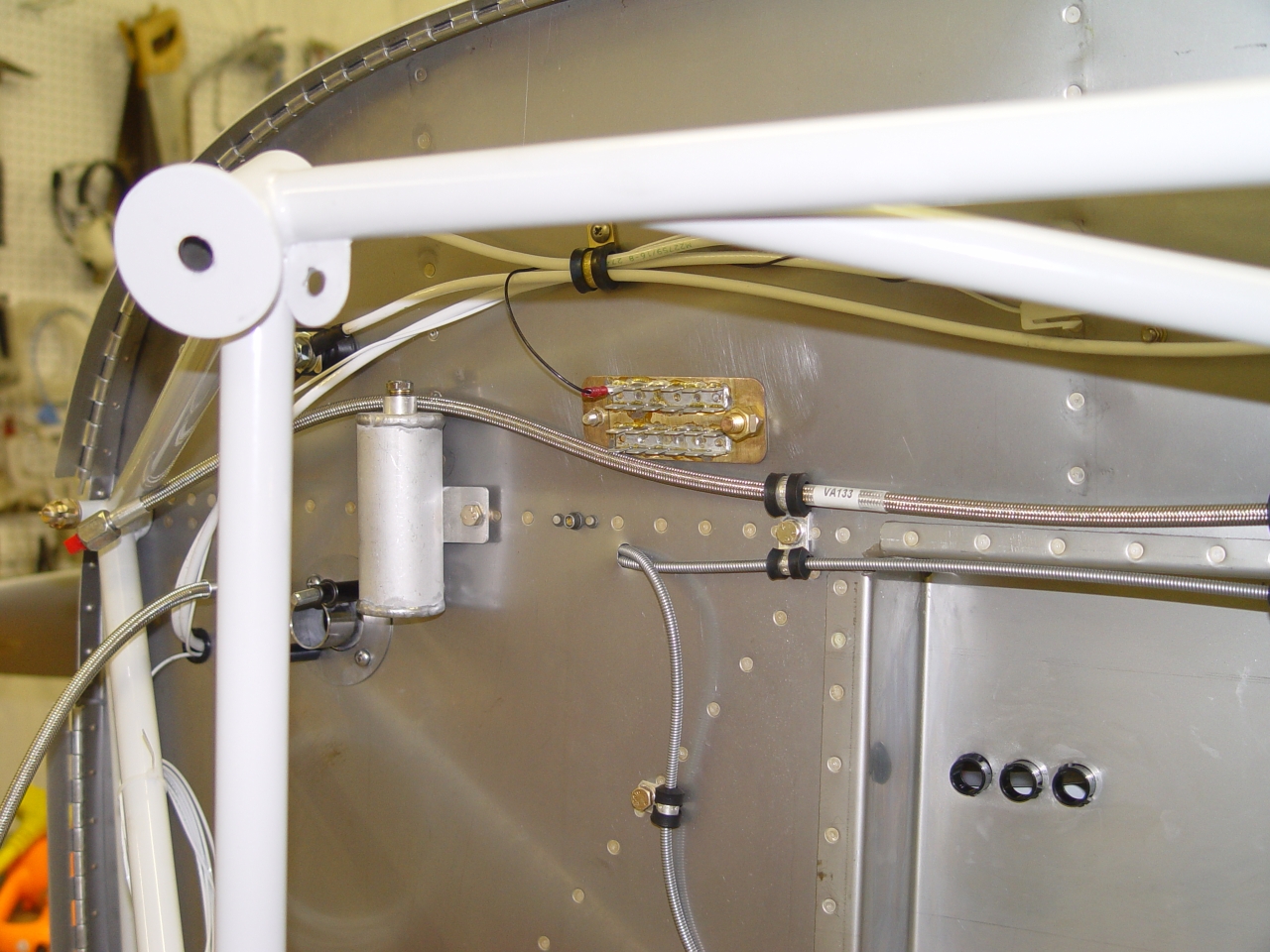

This has worked well for me so far... at least no regrets so far. You can locate this by reference to the brake fluid resevoir. Access to the cockpit side is primarily thru one of the holes the plans suggest you make in the instrument panel bulkhead. I'm wiring it up now.

Thanks, guys for the advice; very helpful.  I think I'll go with the same spot Bill shows in his picture.  I stumbled across a pic of Van's prototype that seems to show it's a good location, too:
http://www.myrv10.com/N610RV/undercowl/P0003082.html
