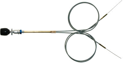

I have had a lot of problems keeping the carbs synched on my 912 ULS equipped 701. I first installed the Zenith issued setup with the torque tube and cables and never was able to keep the carbs synched with that for very long. I found a pushrod setup that a fellow Zenith builder came up with( can't remember his name but he was a prof from Texas). That design used pushrods from the torque tube on the firewall forward to the carbs. I doubted that would work for me cause every time the motor torqued in the mounts I was afraid it would change the synch, but I tried it anyway, and found it as I expected. So I abandoned that rig and tried to find a way to mount the torque tube to the motor and actually did, using the 2 threaded bosses on the top rear of the rear cylinders, and down braces from the rear of the carb cable holder. But I abandoned that cause I was afraid the bosses would crack out; there isn't much meat there; and that vibration would be transmitted to the carbs from the downbrace. So I am back to square one and I guess about to go back to a cable setup; after all that is what most of these things are running, and have since forever ago, so that must be the "best" setup out there, right? My original cables were spring loaded wide open as they came from ZAC; that was aggravating as hell, fighting the throttle springs all the time and having to lock it every time you wanted to take your hand off it.I am thinking about going to the spring loaded idle type...have any of you done that? Seems like that might be a lot more convenient particularly in the pattern. I don't worry about it quitting and going to idle. I figure if it does then it was probably just "my time".If any of you have experience with the spring load idle please pass it along. Also is it essential that the cable housing/wires be exactly the same length as the ones going to the other carb? I haven't seen anything on that, and it doesn't seem necessarily that they should be but maybe so. I was using the vacumn gauge set from Lockwood, which I found near useless because of gauge fluctuation, which on my particular pair couldn't be adjusted out with the valves. I am using a plastic tube loop with oil in it now which I think is reliable but am wondering if it isn't way too sensitive. Your experience appreciated, and sorry to be so long winded here. Thanks

Have you considered using this:
http://www.mcfarlaneaviation.com/Details.aspx?ID=11744352&Article=199
Throttle Control for Dual Carburetor Rotax Engines
Innovative design allows a neat, clean installation without a clunky splitter box
  • Super-smooth friction lock
  • All metal construction
  • Teflon lined for smooth, consistent control
  • Available in 4, 6, and 8 foot lengths
    • Measured from panel fitting to end of conduit, wires extend 6 inches beyond conduit
    • Easily trimmed to length
    • Longer controls available upon request
  • Two knob styles available: Standard or Ball
  • Manufactured to the same quality standards as McFarlane's FAA-PMA parts
  Specifications:
  • Panel Fitting: 1/2-20 UNF x 0.67 inch thread
  • Slip Fit Conduit Terminals: 2 each with 1/4-28 UNF x 1.00 inch thread
  • Conduit: 0.188 inch OD Teflon lined wound conduit
  • Inner Wire: Heavy duty 0.062 inch diameter, 1x7 stainless steel twisted wire per MIL-DTL-87161
  • Travel (stroke): 3.75 inch maximum
  • Design Work Loads:
    • Push: Not Applicable (designed for pull loads only)
    • Pull: 10 lbs maximum
  • Typical Locking Force: 1 to 10 lbs (locking force dependent on friction lock engagement)
  • Operating Temperature: -65 to 450 F
-- Craig

jpspencer(at)cableone.net
PostPosted: Fri Apr 24, 2009 7:16 am    Post subject: Throttle cables/Rotax 912 Reply with quote
Craig
thanks for the link. I called them this morning with questions. Looks like that may be the simplest solution yet. There is still the problem of the springs but I am hoping to be able to go with a lighter one with this cable setup; they thought so, and maybe be able to rig a simple spring load idle control. I ordered one and will give it a try, and then report back here to all the folks. It's a new production item and won't be available for 1-2 weeks, but I will be glad to wait if it solves some problems.
Thanks again. This internet thing is sumpin else
Joe
will report.

bobkat
Joined: 07 Sep 2008
Posts: 143
Location: Bismarck, ND
PostPosted: Fri Apr 24, 2009 10:51 am    Post subject: Throttle cables/Rotax 912 Reply with quote
I would have put a vernier type of dual cable throttle on had one been
available, so I put the ordinary one on. Doesn't creep, in fact I haven't
adjusted it for months.
I got mine from ?Aircraft Spruce? or maybe it was Skystar themselves and I
think they had them custom made.
On my 701 I used basically the same sytem as suggested by Zenith, but
instead of that T-handle on both sides I put a regular friction throttle
cable on the left, left out that goofy friction block on that common rod
and put on the stock T-handle to the right in case I ever wanted to fly much
from there. The Kitfox has the throttle control in the center so a second
set up isn't an issue.
Rigged up like this you still have those safety springs on the carbs but
never are aware they are there. Anything happen to the throttle control
mechanism and it'll get you down. At altitude it may not be any big deal,
but over water, trees or near the ground it could be a life saver!
bobkat

Don't worry about the springs, Joe! I almost pranged my kitfox because the original builder had removed them and installed a solid cable push/pull system. Worked perfectly until one day I had taken just taken off when one of the solid cables broke and the carb on that side went to idle. I was able to slip it back in to the very short field with trees on the far end, stopping with the spinner inches from a tree!
So the first thing I did was redo it to the original system. Those springs are there for a reason!
If you use that double cable system above pictured (I put that one on the kitfox) you can easily adjust the throttle tension so you are not aware that the springs are there. And the carbs stay balanced!
But those springs could save your life someday. Isn't there a picture somewhere of a 701 in a grove of trees because lack of those springs?
The original system, especially using those two cabled throttles works really well. If it ain't broke, don't fix it. But for safety's sake leave the springs in.
A bit off topic, but I heard that Rotax was working on a single point throttle tttchemnt system. That will make discussions on the annoying double cable throttle problems and keeping the carbs balanced obsolete! Yeah!

>KIS.- Add only lightness and simplicity to any airplane
Amen. In fact KISS is the 2nd reason(spring fight is first) I would like to get away from the ZAC throttle design...if I can make 2 Cessna type push/pull cables from a common throw work then I can get away from the springs and torque tube, and all those bicycle type cables. That may not work either but will give it a try. When mine was rigged without springs it was so much nicer to fly...just like a normal airplane. But the carbs wouldn't stay synched.Some of all this I think depends on your expectations, as some are perfectly happy with the plans rig. Others not.
As to why 2 carbs on the 912...mainly I think it is for high power/weight. But it does add a lot of complexity, as does the water cooling and the external oil tank and all those oil lines and the gearbox. Complicated and fussy...it's kinda like automatic that when you decide to go with a Rotax you are giving up simplicity. I would have much rather had a Continental or Lycoming but they are too heavy and won't perform...that is if you are interested in radical, optimal STOL, anyway. So I reluctantly bought the Rotax cause, for me anyway, radical STOL is about the only reason for this plane's existence. There are better choices if good all around performance and nice flying qualities are what one wants...but man will it ever come out of the hole!!
