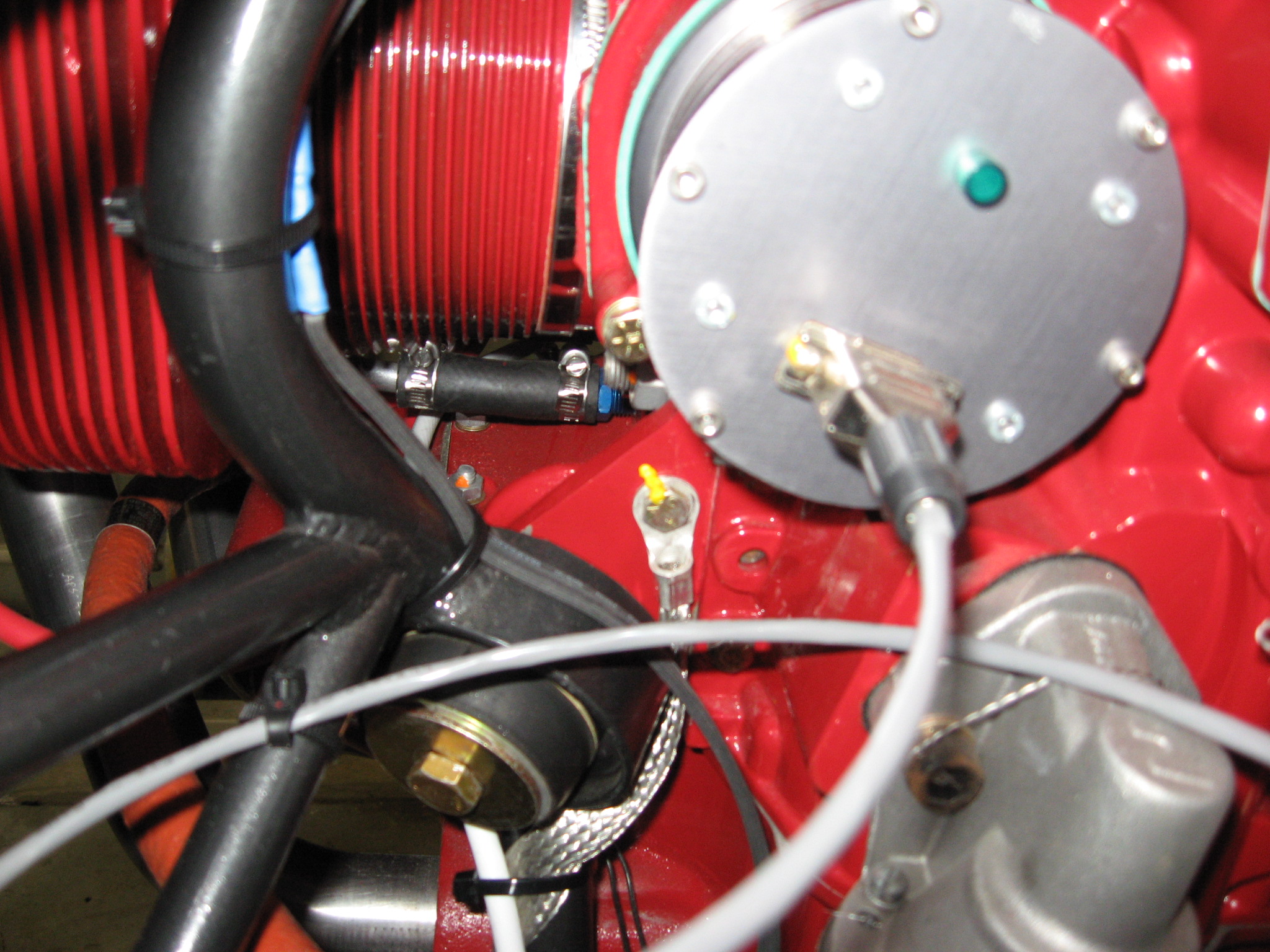

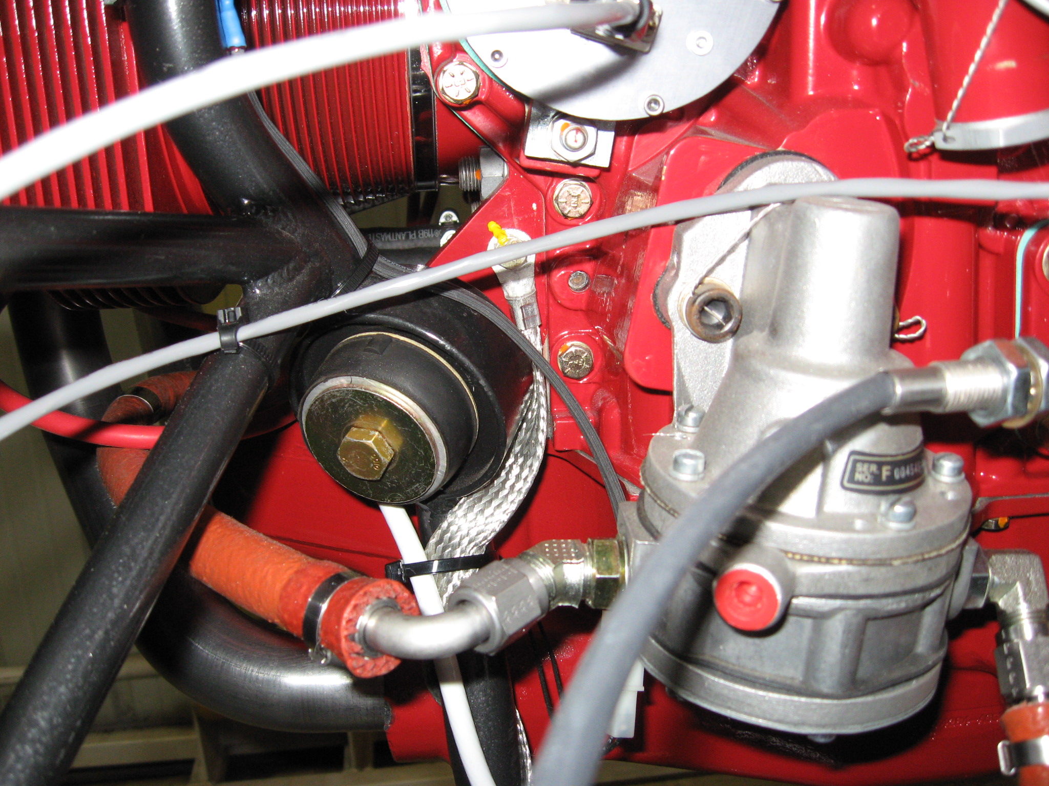

On closer inspection of my Lycoming I found there are two pre-determined
grounding locations on the IO-360 engine. Those bearing the Dynafocal
mount setup have a purpose built hole on the ear of lower mounting tabs.
I've attached a few pics.
Glenn

PostPosted: Tue Apr 07, 2009 7:26 am    Post subject: Affixing an Engine Ground Reply with quote
Glenn,
I would grind the paint off where you have attached the ground in order to
ensure a good connection...

PostPosted: Wed Apr 08, 2009 5:14 am    Post subject: Affixing an Engine Ground Reply with quote
Ah yes, thought of that. I ground off just under the bolt, so as to keep
up with appearances.
