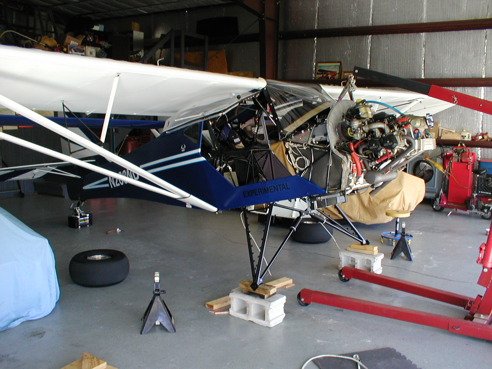

My Northstar sending unit is installed vertical a few inches above the gascolator prior to the fuel pump and yes the wire can be shortened as specified by the instructions. I shortened mine to a total length of about 3 1/2 ft spliced it and it works perfect.
I have included a picture but not a good one. It barely shows the installation. If you look at the lower left of the firewall you will see where the fuel line (aluminum goes down to the gascolator and then goes up to the fuel pump [in red fire sleeve). About two inches above the gascolator is the fuel sending unit for the Northstar (also wrapped in fire sleeve) there is a white circle in the line, at that location. I then cut the wire and sent it to the instrument panel for the gauge. Sorry I don't have a better picture but the picture was made to show my bush gear installation.

Thanks for the info and the photo. My installation is exactly like yours. After I installed it, I got to wondering if I had screwed up by placing it upside down.

Dick can I get a close-up on how you attached the oil cooler?
