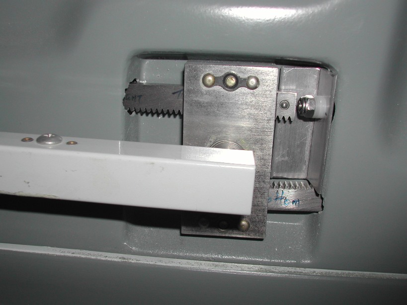

PostPosted: Mon Mar 30, 2009 2:06 pm    Post subject: Baggage door lock Reply with quote
I used the 2 keyed alike Spruce locks on the baggage door and pilot’s door. That left the copilot side door to lock. I did not really want another lock on the RHS, so built an internal ‘lock’ for the RHS door. A piece of angle with a nut/bolt that prevents retracting the rack. Took 5 minutes to make, is very secure, is easy to insert/remove and there is no way you can open the door from the outside (or inside for that matter).
Cheers,
Ron
