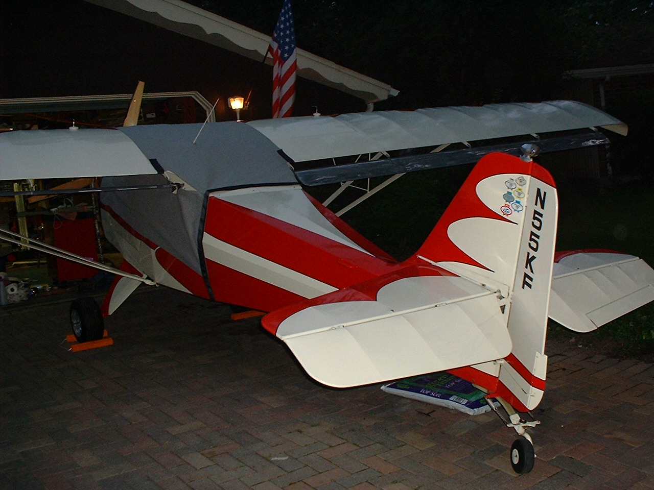

Dick Maddux
Joined: 24 Jun 2008
Posts: 516
Location: Milton, Fl
PostPosted: Sun Mar 22, 2009 4:39 am    Post subject: Rudder trim tab Reply with quote
James,
This is the way I did it. Just a small aluminum plate I attached with 4 #6 or #4 screws (can't remember which) so that I could remove it or increase the tab size if I needed to. I had to adjust the bend a couple of times but now it is spot on (as the British would say). I have a picture from my files albeit not very good.
      Dick Maddux
      Fox 4
      Pensacola,Fl

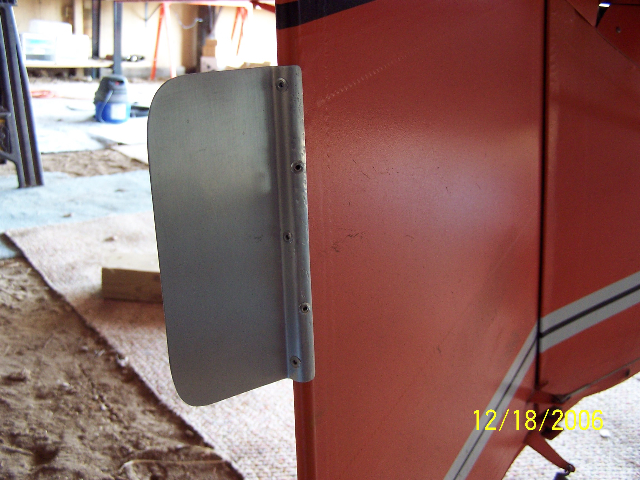

Lynn Matteson
Posts: 2778
PostPosted: Sun Mar 22, 2009 8:09 am    Post subject: Rudder trim tab Reply with quote
Here's how I did mine, James. Take the aluminum plate and "forge" it
over a scrap piece of tubing or a 3/8" extension, and you'll be able
to get the pop rivets into 2 different rows around the trailing edge
tubing of the rudder. This will allow for a MUCH stronger attachment
than if you just ran a straight row of rivets. If you don't...and you
do much altering of the tab.....you'll run the risk of bending the
rivets and the tab will become loose. I attached mine with aluminum
rivets so I could drill the out if I decided on another method. My
aluminum rivets haven't loosened in the 500 or so hours since I
installed it.
Lynn Matteson
Jabiru 2200, #2062, 618.4 hrs
Sensenich 62x46
Status: flying

 Filesize:  403.12 KB
 Viewed:  7934 Time(s)
Lynn

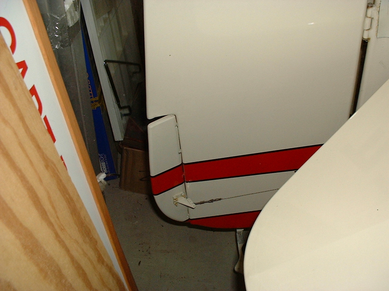

rliebmann(at)comcast.net
PostPosted: Sun Mar 22, 2009 8:19 am    Post subject: Rudder trim tab Reply with quote
I made my rudder trim a cockpit adjustable one and am happy with it. If
anyone wants more info on how it is made, just e-mail me on or off list.
Ron rliebmann(at)comcast.net

 Filesize:  302.48 KB
 Filesize:  309.97 KB

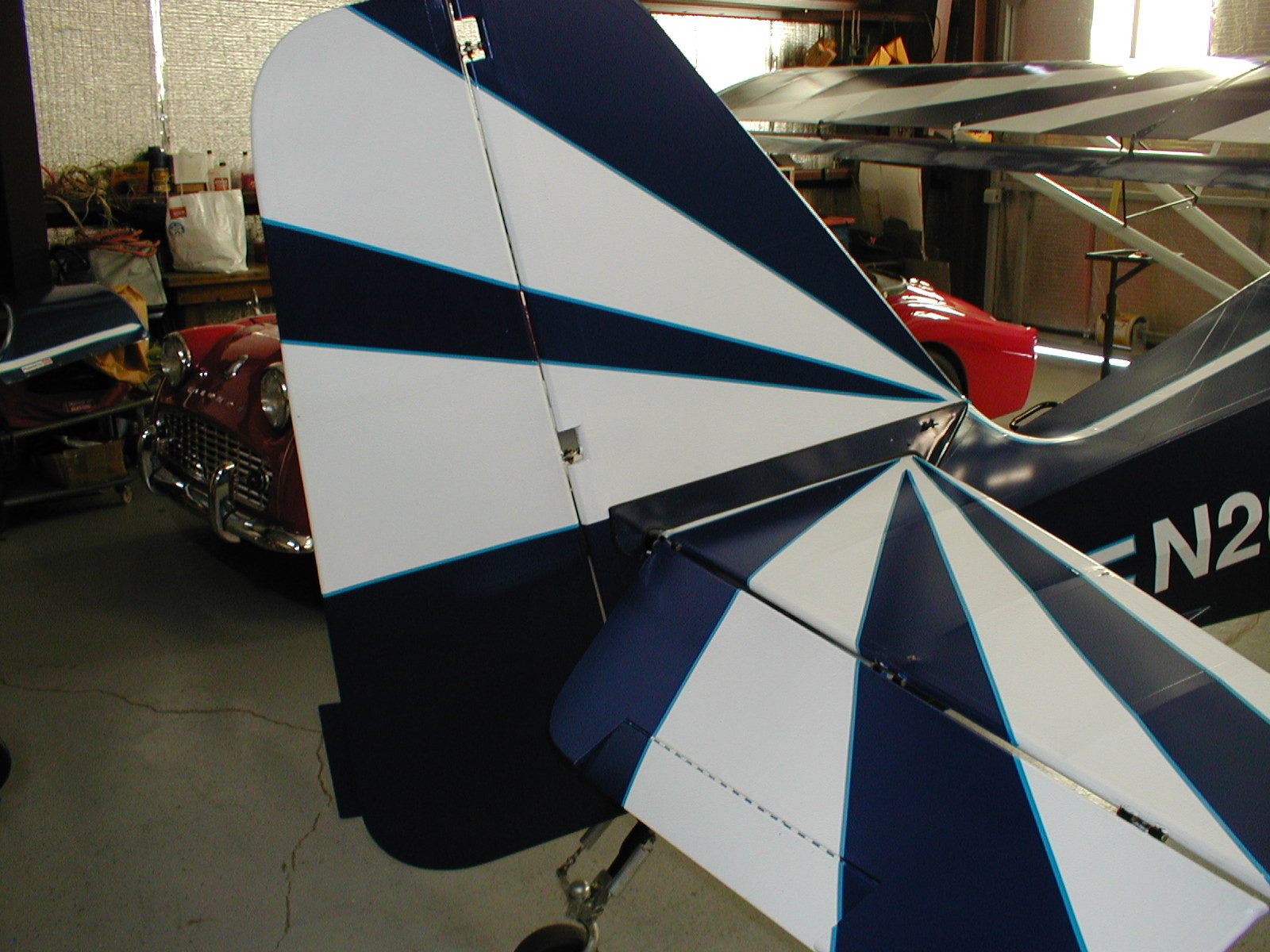

patreilly43(at)hotmail.co
PostPosted: Mon Mar 23, 2009 10:10 am    Post subject: Rudder trim tab Reply with quote
Dick C The light blue lines striping the edge of the dark blue on your plane C is that tape or paint?
Pat Reilly
Mod 3 582 Rebuild
Rockford CIL
From: Catz631(at)aol.com
Date: Sun C 22 Mar 2009 08:36:41 -0400
Subject: Re: Rudder trim tab
James C
