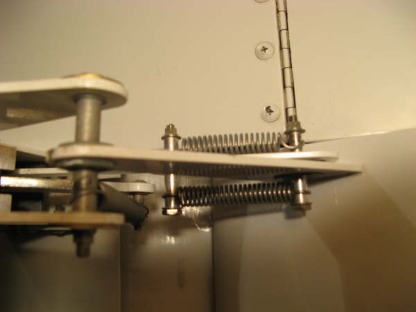

  Just added a second spring to my downlock mechanism.  Pretty easy mod and now provides a resounding audible clunk
confirmation when lowering the gear.  The audible confirmation with just the stock springs was getting somewhat passive and difficult to confirm.

Glenn...very nice...now why didn't I think of that?...yu b a clever fella...

Hey Fred C thanks. No negatives yet and provides a warm and fuzzy feeling on short final that all is well. I also replaced the
original nylon legs with MDS filled nylon legs purchased from McMaster. I am experimenting with 1/4" longer legs to reduce the
rocking even more. Now there is no wing rocking at all until the TW is lifted and then its only there for a couple seconds before
rotation. Much improved on landing as well as soon as the main is down C the OR wheels are down as well preventing any side
loading or weight transfer from getting started. This does add a slight preload to the legs but they become HIGHLY loaded if
any side to side weight transfer starts up with the standard length legs. I really like it so far and can taxi up to 45 mph with
no rocking whatsoever but YMMV.

Hey Glenn...sounds good...I've always been troubled by the eccentric loading on the bolt which holds the spring (on the original).

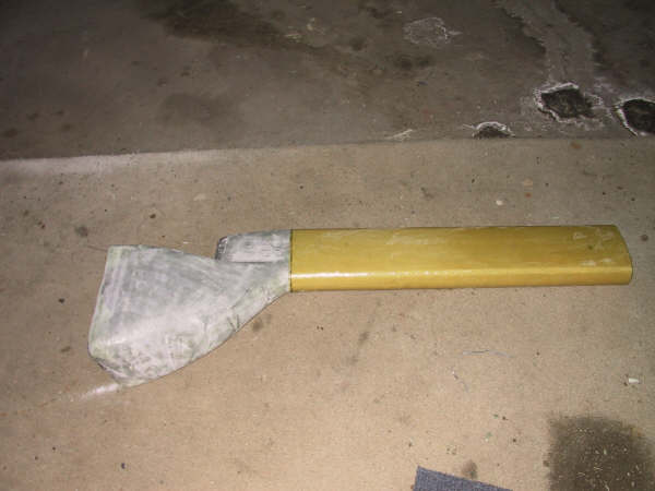

Springtime project will be to get the exhaust augmentation system going C hopefully reducing cooling drag significantly.  Attached a pic.
