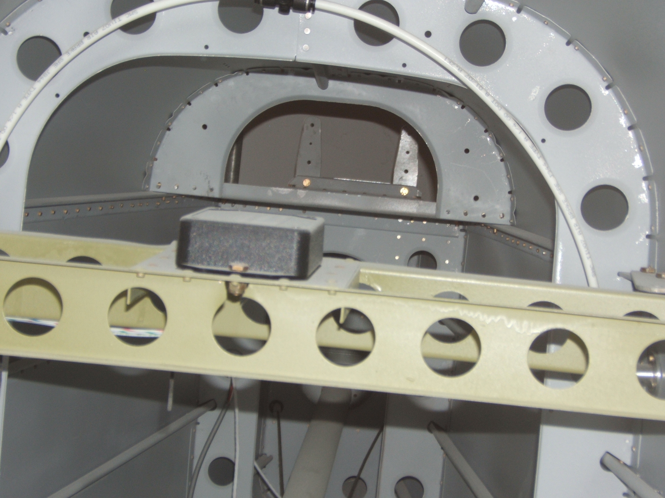

I built a shelf for my magnetometer, about 1/2 way back in the tailcone (see picture), and it would of been lots easier to do while building the tailcone. Simply mount it on the top longeron, and it will be very close to level. You can the fine-tune the level and direction, when you install the magnetometer.

I too wish I had built a shelf for my dual magnetometers back then. I
built and discarded one I tried to build to hug the very top of the cone
after the fuse was all together.. The challenge is figuring out an
optimal location relative to all the magnetic fields to be installed
later. 1) the elevator trim motor, 2) the pitch trim motor, 3) the
strobe power unit (which assume kicks of some field).
I Installed my tray further forward in the same bay and biased to the
left side of the cone to put it equidistant from the 2 trim motors.
Of course, the unit may not be as sensitive as suggested. Somewhere
down the line some one will have a documented a serviceable location
for the various brands and configs.
Jim Berry
