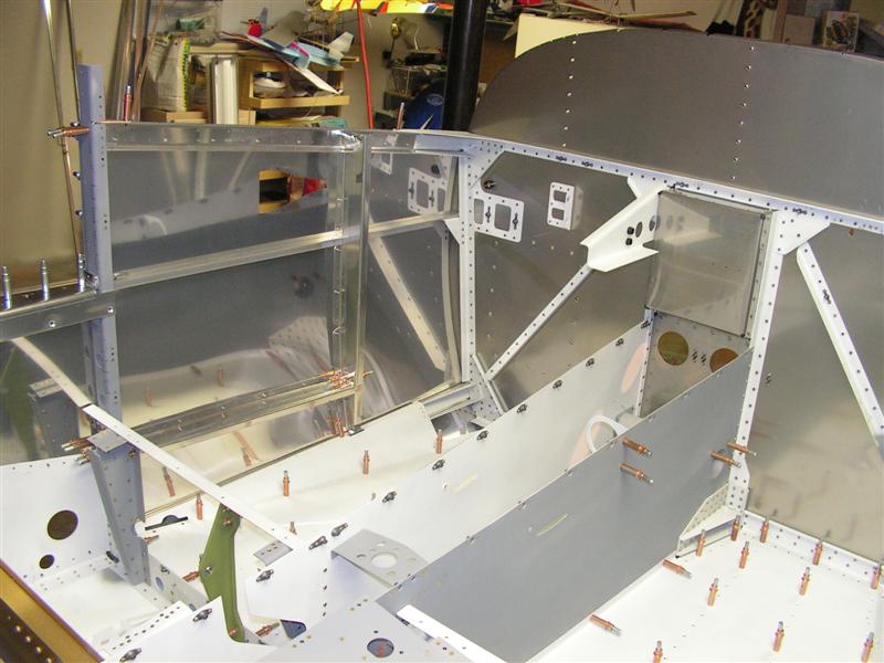

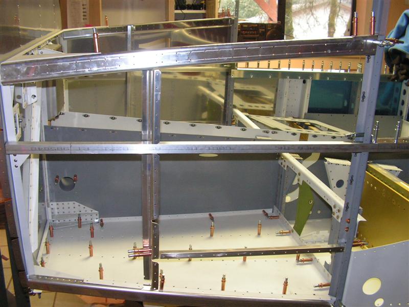

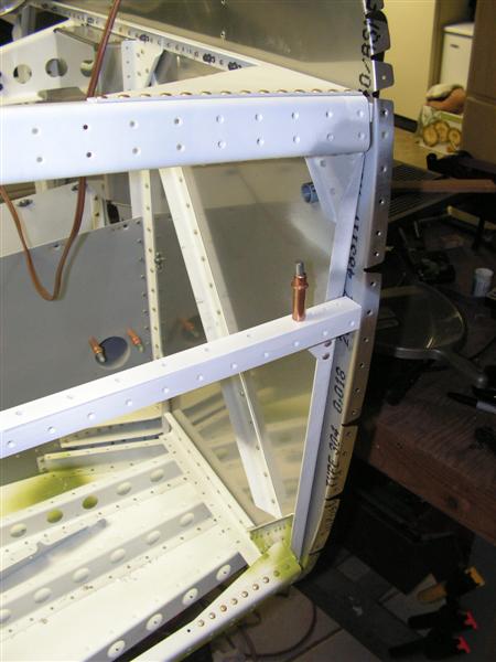

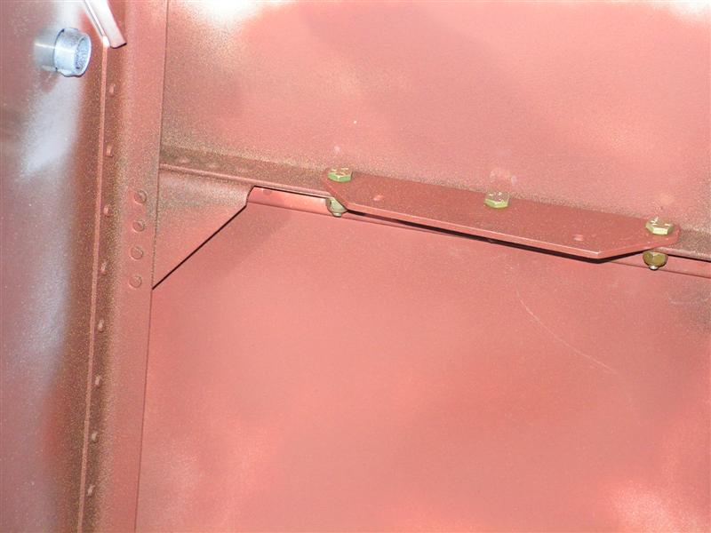

Hi Rob C
Here are some pictures of what I did. Also look ahead to page 14 for a close-pu.
Vern Smith (#324 finishing)

PostPosted: Mon Mar 09, 2009 10:14 am    Post subject: F 1013 Longerons Reply with quote
Rob
The longerons do sit on top of the gusset. I enjoyed this section a great deal myself, even though I made my first two perfect longerons exactly 1" short. Wait until you get to the point of attaching the skin to the longerons over this gusset, it's a real challange.
