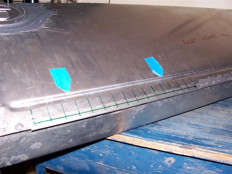

A follow up to my leaky tanks post
Two of my 4 tanks leaked. One leaked on the front seam in 2 spots. The other leaked around one of the threaded fittings. Rather than using a sloshing agent I tried the following.
The leak at the threaded fitting was right in a corner that I packed with proseal mixed with a little bit of fiber glass. This was done on the outside of the tank. There were lots of rivets shop ends poking out for the proseal to grap onto.
The other one was on the long straight seam. I bent up a U from 5052 aluminum and after removing the rivets from the leaky area I wrapped the seam with this U and drilled it to use the same rivet holes. Next I stuffed the U with proseal, hammered it on with a mallet and set the rivets. I should know late tomorrow if this worked.
Here's a picture of the patch.
Dan Dempsey

Just a final word on this thread. Both the patches worked, so I'm finished with the tanks until installation time. Thanks to those who responded.
Dan
| leinad wrote: | A follow up to my leaky tanks post
Dan Dempsey |
