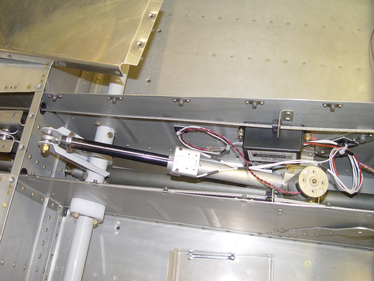

The Safety trim can go many places. Mine is under the panel.
The FPS mounts well on the inside of the tunnel wall.
Just make sure to tie up any wires so nothing can interfere
with the flap mechanism.

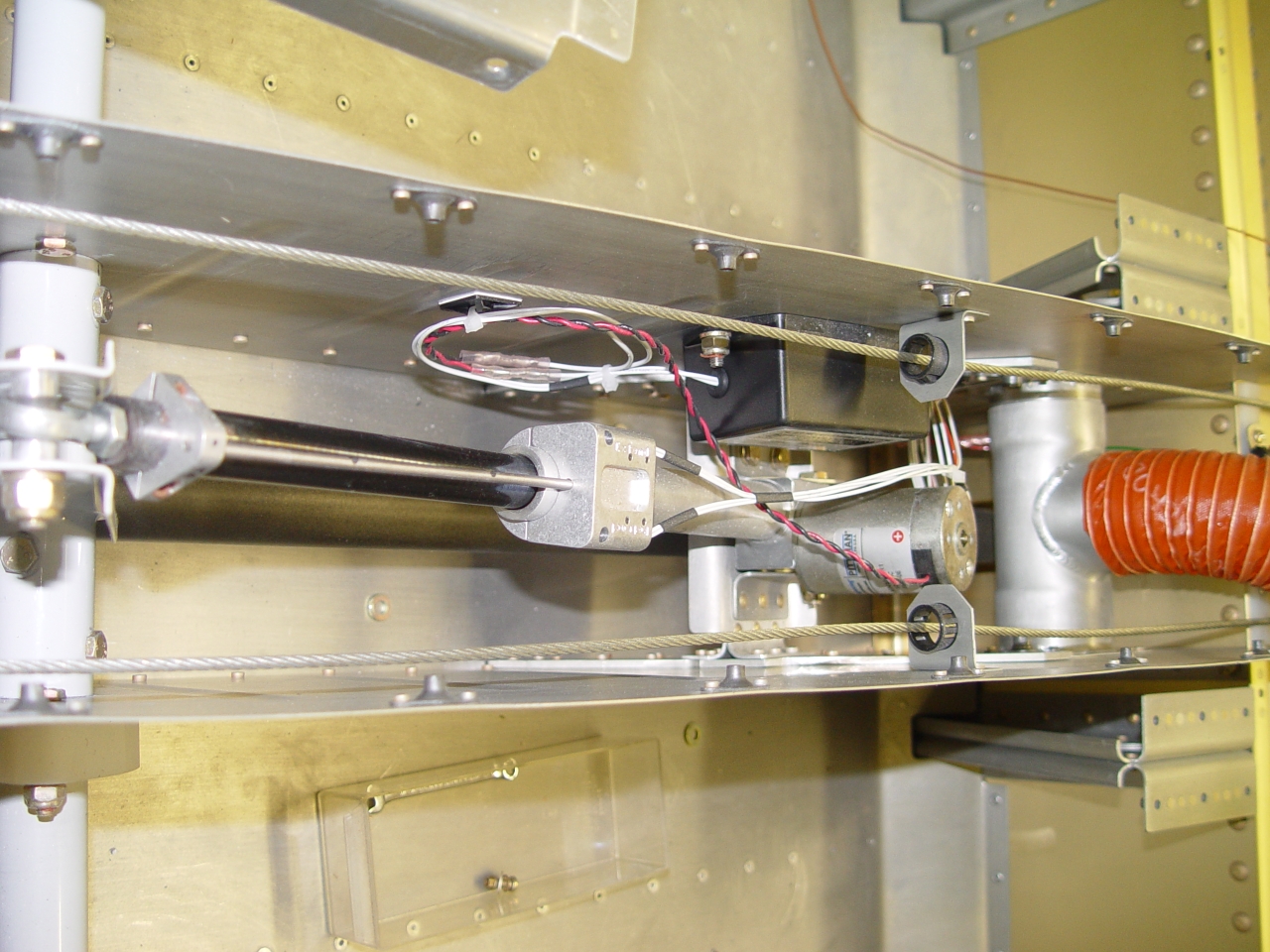

Here's what I did with mounting it in the tunnel. Plenty of room in
there. The wires are run forward thru the tunnel. I used some tape
backed wire holders but they will be riveted.
