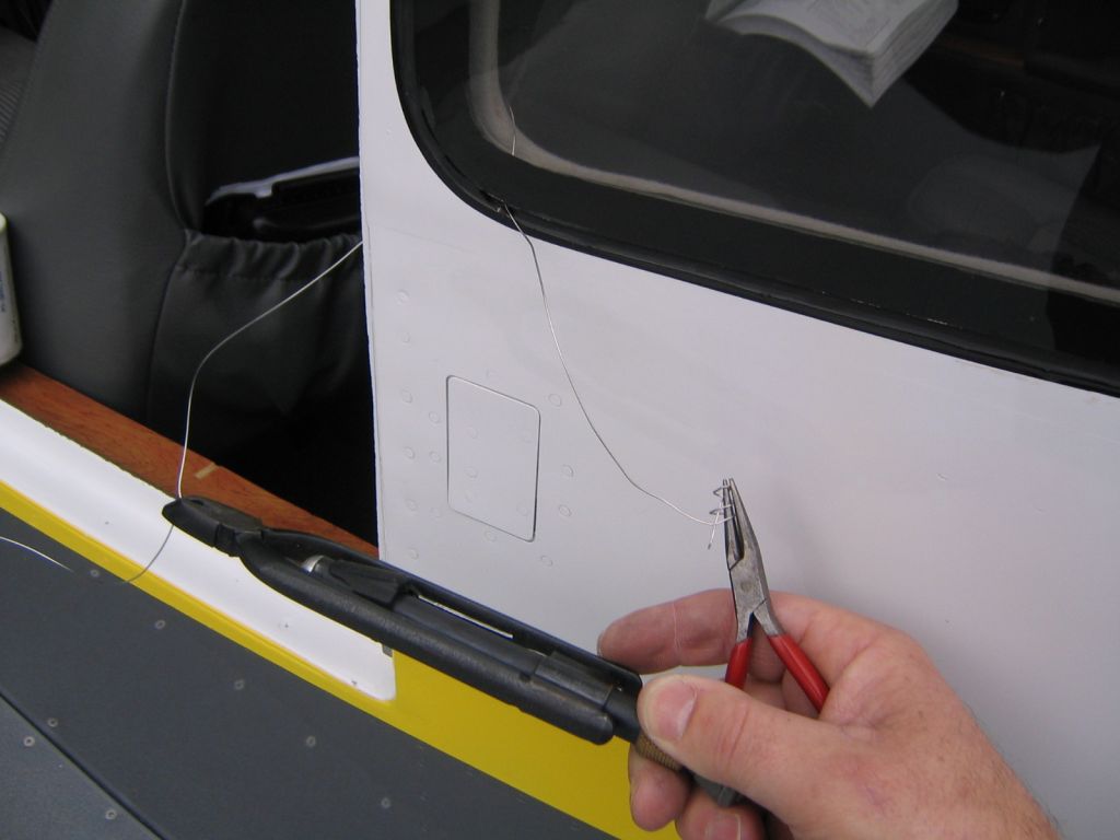

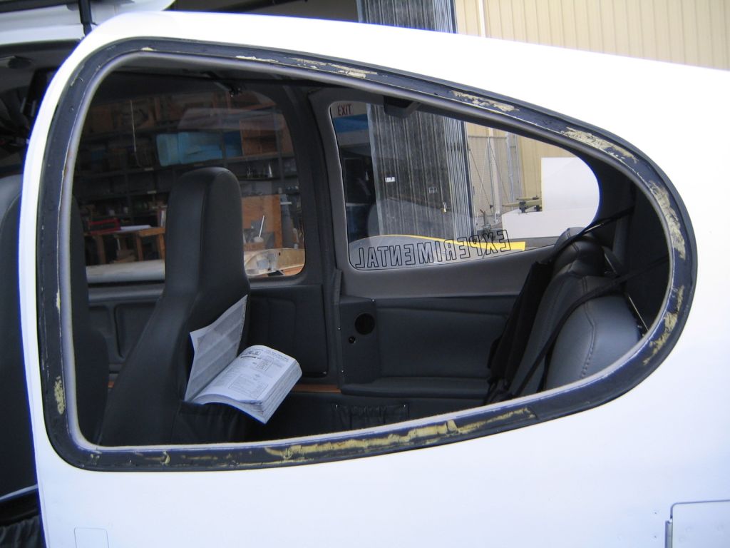

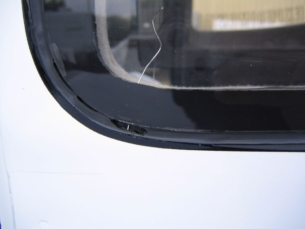

A few people have asked about removing a window that was installed with SilPruf.
The weatherman said this would be a good time to take the plane down for a few days, so I decided to replace our sun-damaged window.
I pulled a little plug of sealant out of the groove on the outside. I was able to pretty easily put a piece of .020 safety wire through the sealant from the inside and fish it out from the outside. Then I just pulled the wire around the perimeter of the window. It took 10 minutes to get the window out.
I cleaned up the old sealant with a scraper and some Scotchbrite, and installed the new window like the others.

PostPosted: Mon Feb 16, 2009 7:17 am    Post subject: SilPruf window removal Reply with quote
Dave,
Did you use this on the windshield as well? Any photos?

PostPosted: Mon Feb 16, 2009 8:53 am    Post subject: SilPruf window removal Reply with quote
I didn't use it on the windshield because of the time involved in molding a joggle into the lower section. It could be done, but it would be a lot of work. I might consider it if I ever had to remove the windshield.
