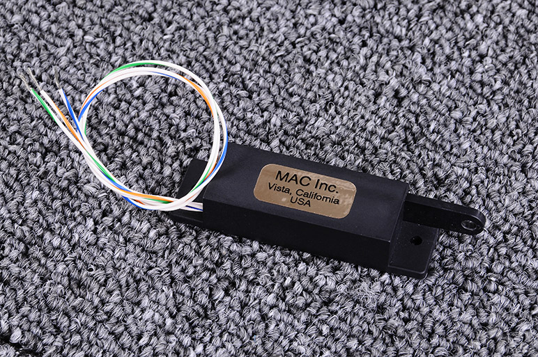

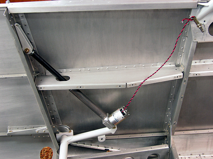

Does anyone have a simple, reliable installation design for the little position sensor from MAC Trim when used with the Electric Flap option on the PP QB RV-8? I've scratched my head for few hours now and have some ideas, but nothing that really seems like its simple enough or not prone to jamming. What have other builders done? Pictures would be great!

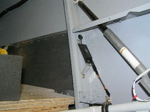

Matt, I simply bent a piece of scrap Al (025 or 032??) to mount my POS-12. Since the screws fastening the support to the bulkhead were inside of the baggage wall (between the baggage wall and the fuselage skin), I used #6 nut plates (for future service). In addition the termination of the wires (pins and barrels) are on the fwd side of the bulkhead (in case I needed to change out the sensor in the future... old photo during construction). You'll need to adjust the length/position of the threaded rod/clevis for the appropriate travel
Pretty simple and has worked well on my AF2500.
