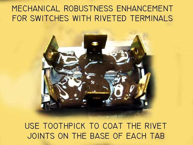

I think you had mentioned that you would test the practicality and function
of adding JB weld to switch rivets to see if it would prevent them from
loosening without a downside. Any progress there?
loosening without a downside. Any progress there? |
Some.
I have looked at every riveted Carling switch in
the shop (about 25 pcs) and found none with observably
loose joints.
I did do some tests to determine that the contact
material (which includes the formed rivet head)
is solderable - as are the brass fast-on tabs.
The conditions are favorable soldering the rivets
to the tabs and then covering the joint with a dab
of JB Weld.
This still begs the question as to return on investment
for this effort.
We've identified no changes to process or design
that would account for a rash of failures in these
switches. The design has been essentially unchanged
for decades and what must be many millions of devices.
I'll suggest it's pretty clear that the failures
were not a function of failure to observe ratings.
It's clear that the strongest potential for failure
happens under the formed head of the rivet. If it's
too loose, corrosion can begin and failure is
a sure thing given sufficient time.
The soldering process is not a quick-n-easy thing.
I was able to get good flow to the two materials
but it was a bit fussy. Couldn't be sure that I
wasn't degrading the joint quality at the base
of the saddle inside the switch while I was making
them "better" on the outside.
If you've got switches that are not yet installed,
it wouldn't hurt to beef them up with some JB Weld.
Use the slow setting stuff so you've got plenty of
time to work carefully. You can also mix up a larger
quantity of the slow stuff and do a batch of switches.
[img]cid:.0[/img]
Take care to avoid contaminating the tabs.
I'm not confident that soldering the contact to the tabs
is an "improvement". The epoxy beef-up can't hurt anything
and it may be helpful.
