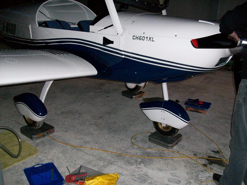

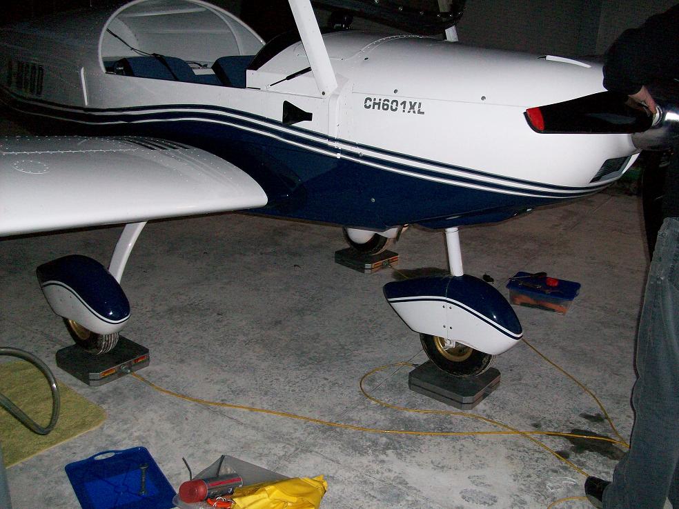

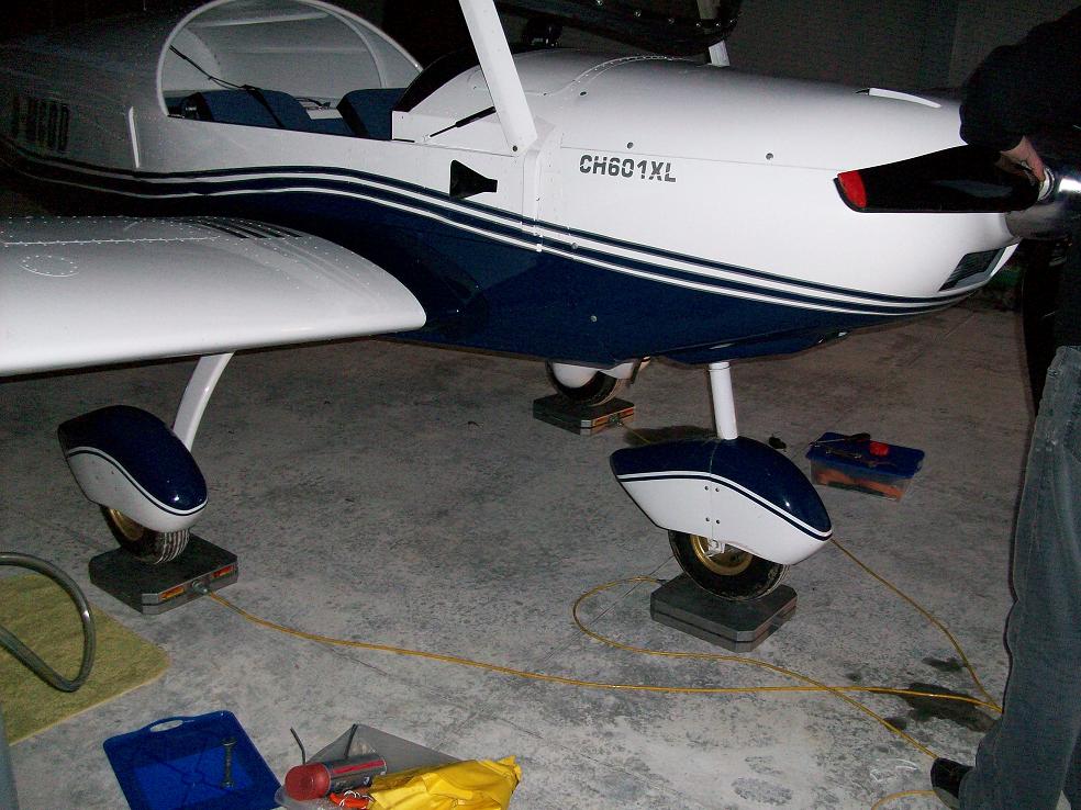

WR 109.0
WL 109.0
WN 105.0
Leergewicht in kg 323.0
all in kg rotax912uls brs radio transponder gps full analog instruments airbox, heater, y stick, ap navaid, strobes, landinglight, BRS, position lights, wheelfairings
2007 czaw 601xl
i checked the weight last week

alex,
did you set the aircraft level (spirit level on cockpit side rails etc) and close the canopy before reading the scales?
Overall weight will be spot on but calculated CofG will be off if you didn't.

all done and similar fig as when new and collected with w&b sheet
