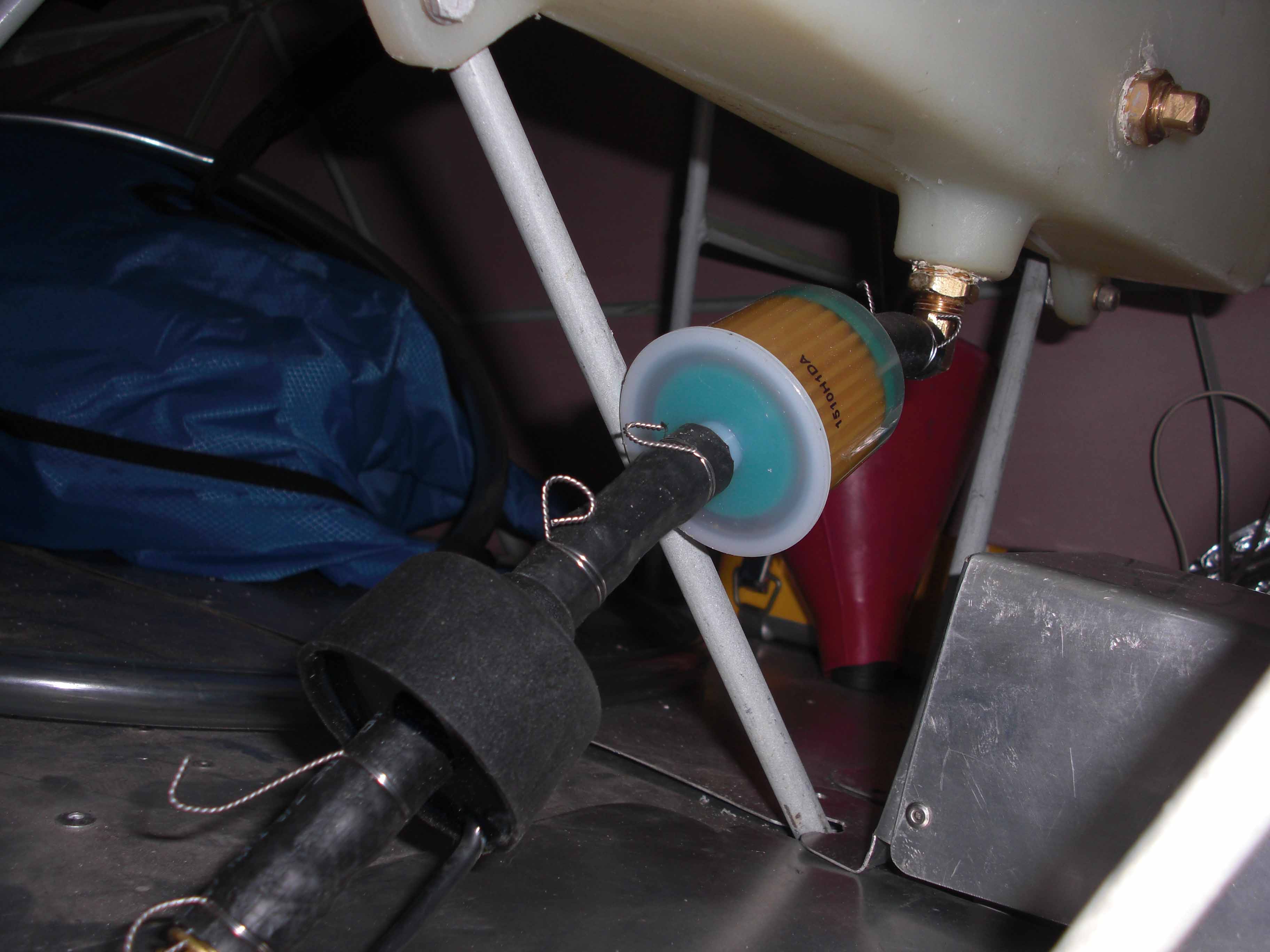

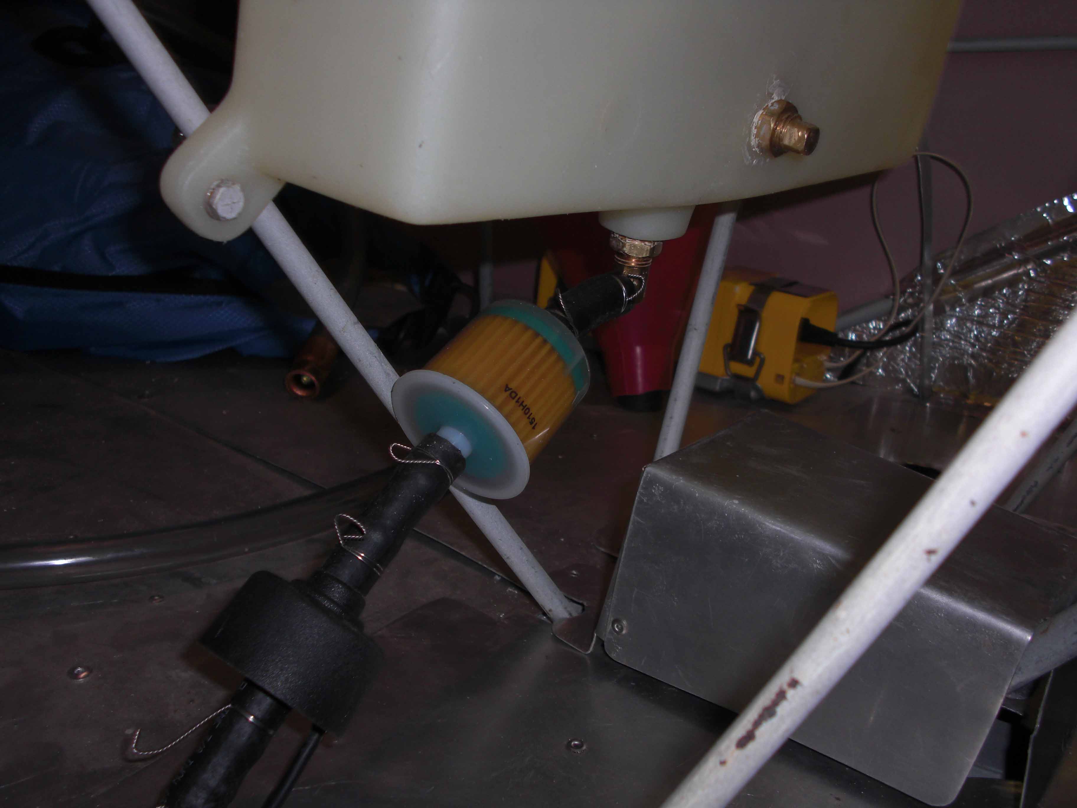

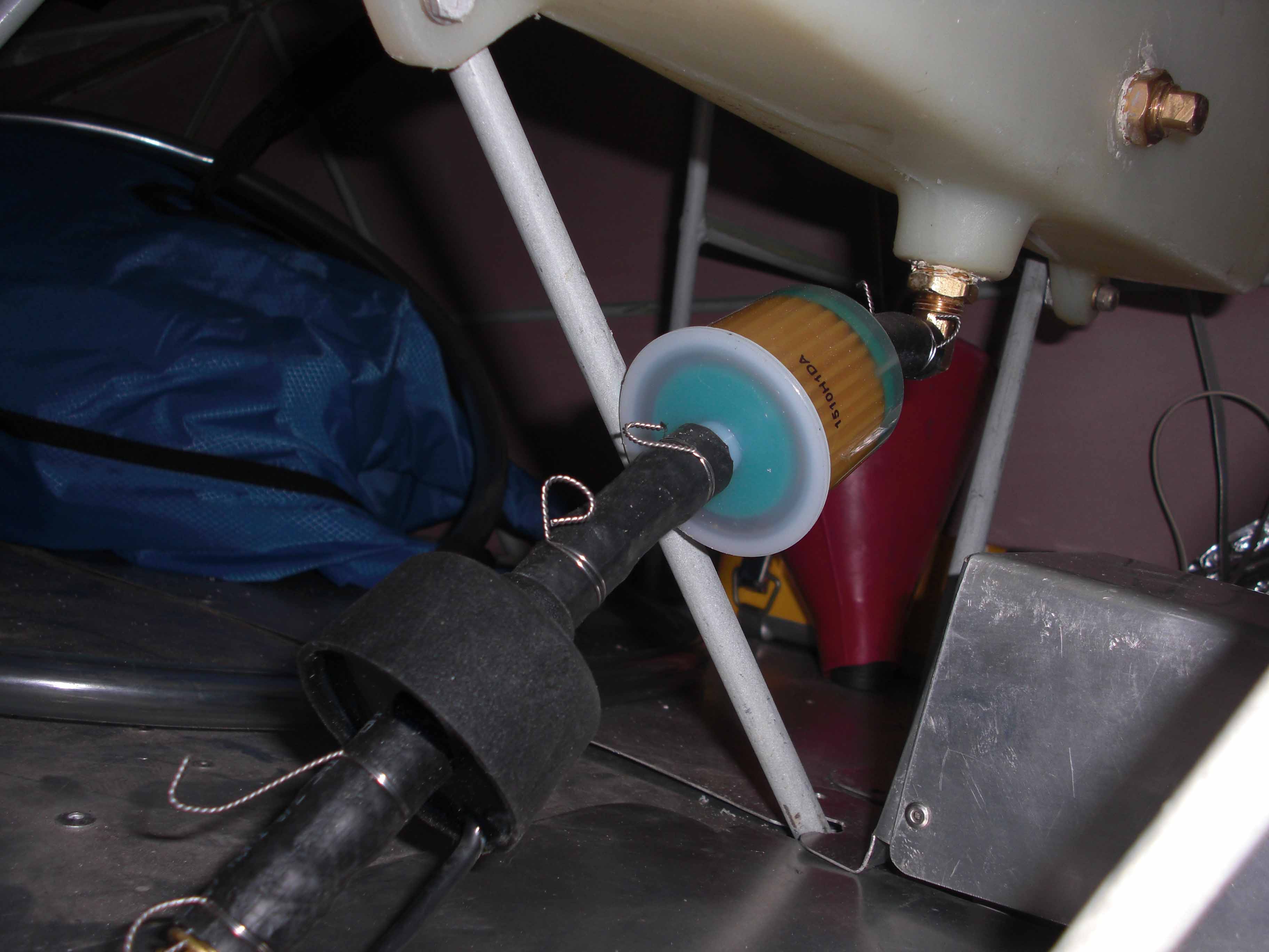

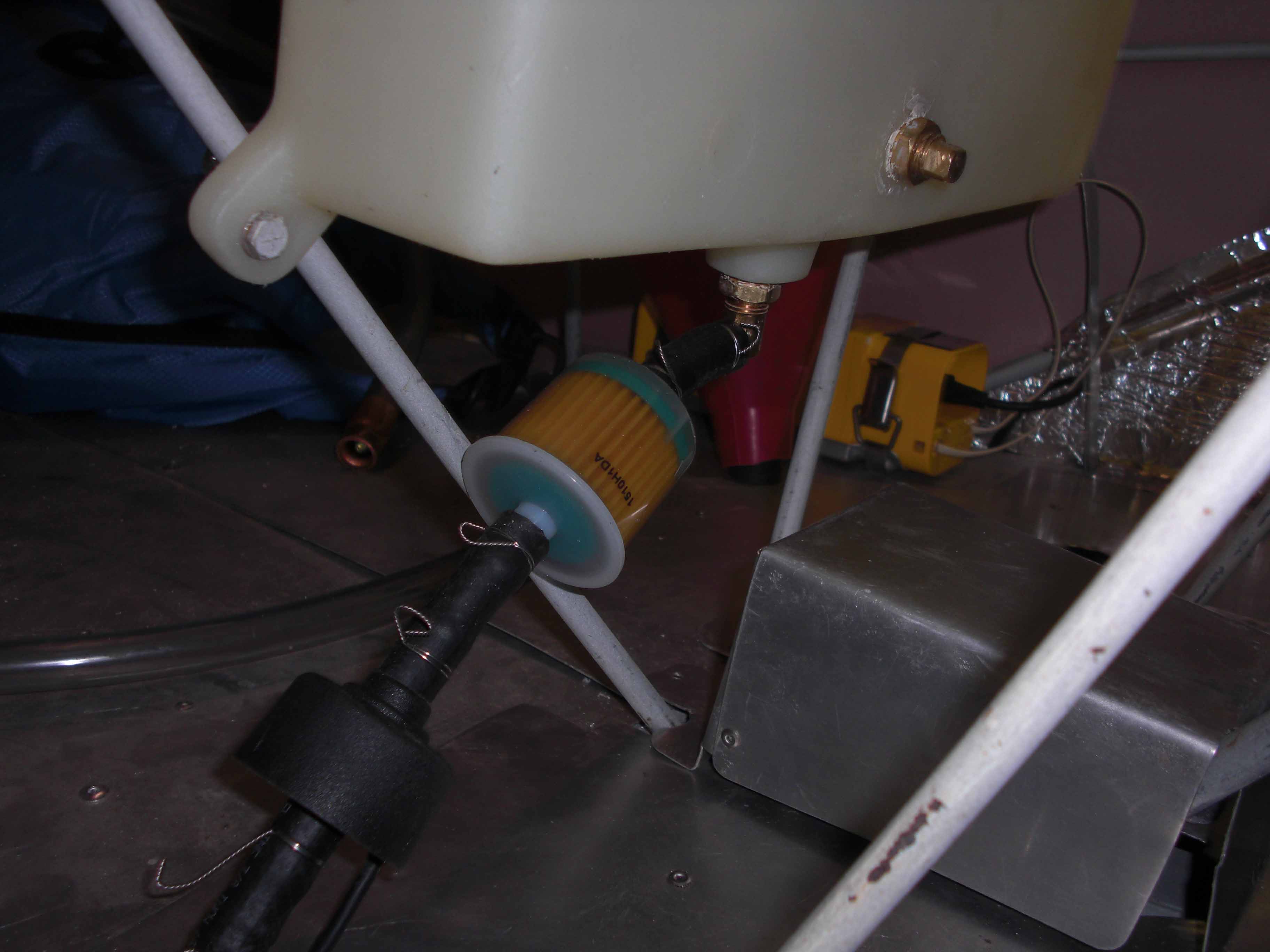

It is a "turbine" in there not an impeller.... now you can brag about having a turbine in your kitfox....
Here are a couple pics of mine
 Filesize:  270.58 KB
 Viewed:  603 Time(s)
 Filesize:  309.39 KB
 Viewed:  591 Time(s)

Lynn Matteson
Posts: 2778
PostPosted: Sun Jan 11, 2009 5:36 pm    Post subject: Fuel flow indicator Reply with quote
Touche.... : )
