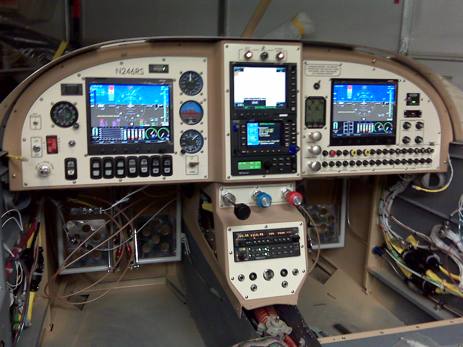

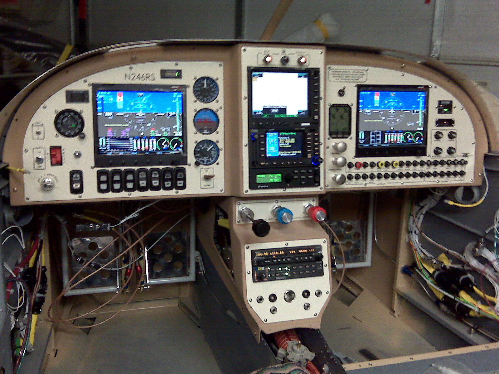

Doug,
I'm not sure you can get it to work with the stock panel. Heres mine with an aftermarket panel and two 3500's. Stein sells one that will work though I'm sure. This picture was well over a year ago, lots more airplane around it now.
Rick Sked

PostPosted: Sun Jan 11, 2009 8:51 am    Post subject: Re: EFIS - Dual screen AFS advanced deck Reply with quote

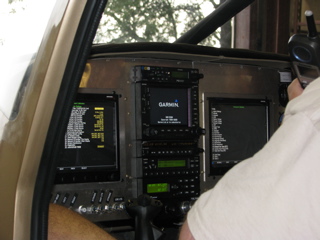

I have dual AFS 3500 set up to change to 4500 with garmin 'stack' between. They are 'shifted 'left' so all is easy to reach. I was initially concerned that the panel lacked 'symmetry but since really appreciate how easy it is to reach 430/530 and the right AFS. The copilot still can use the right AFS and also reach the radios. The autopilot also is in each reach, and easy to see. cheers. larry

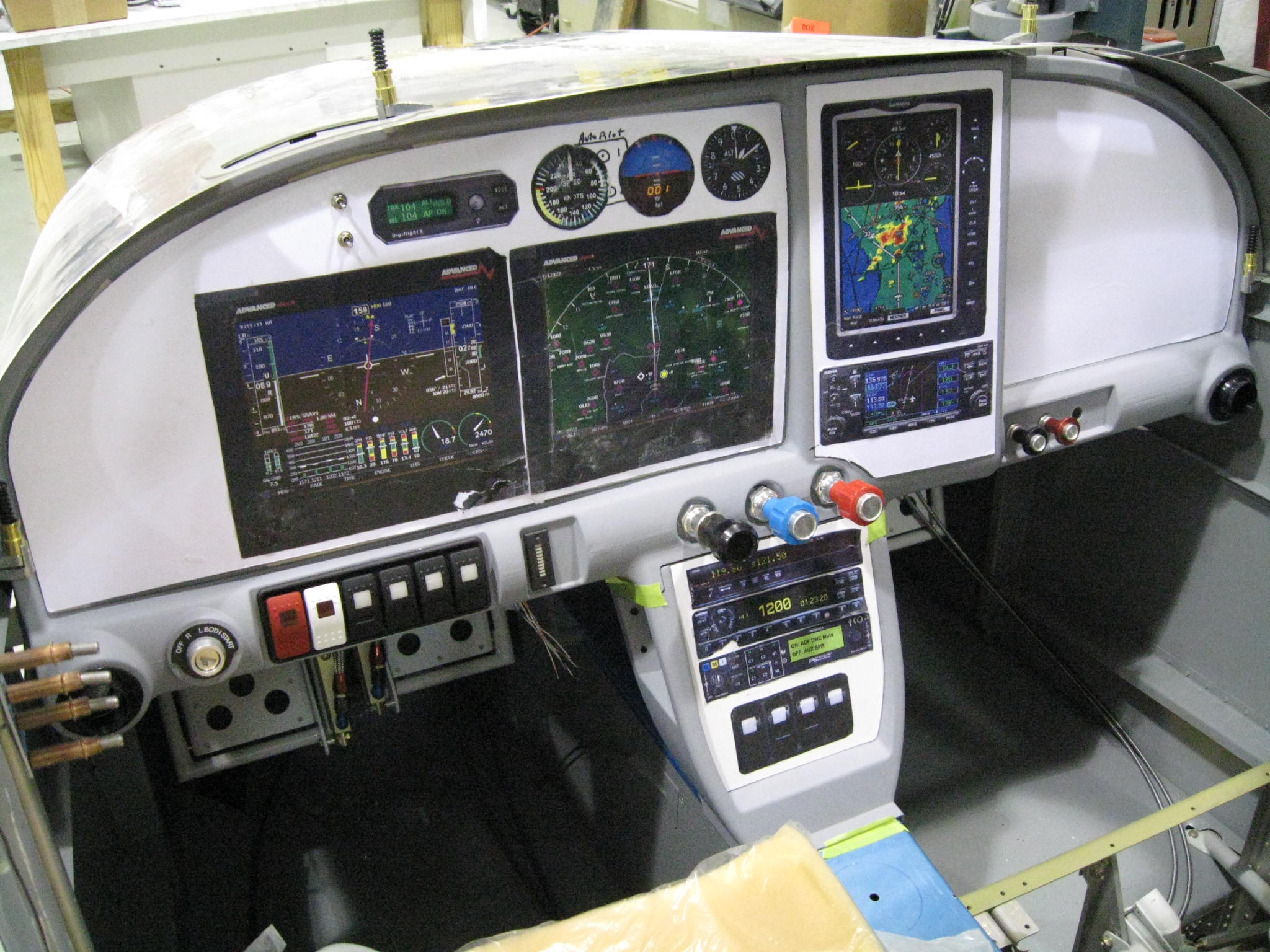

PostPosted: Sun Jan 11, 2009 11:26 am    Post subject: EFIS - Dual screen AFS advanced deck Reply with quote

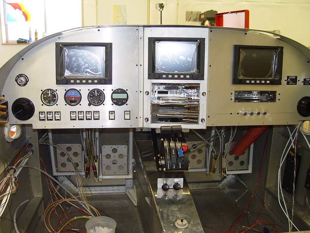

Slightly off-topic, but here is my 3 screen GRT with Stein's "center
canted left" panel blank. Fair symmetry here but still pilot optimized.
Bill "wiring it up" Watson

i'll see if i can get the picture attached. it's a crummy picture, but only one i have of the panel. haven't finished it yet--still trying to figure out what kind of labeling to do. i'll take some pictures next time at the hangar

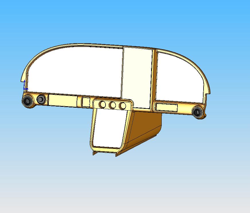

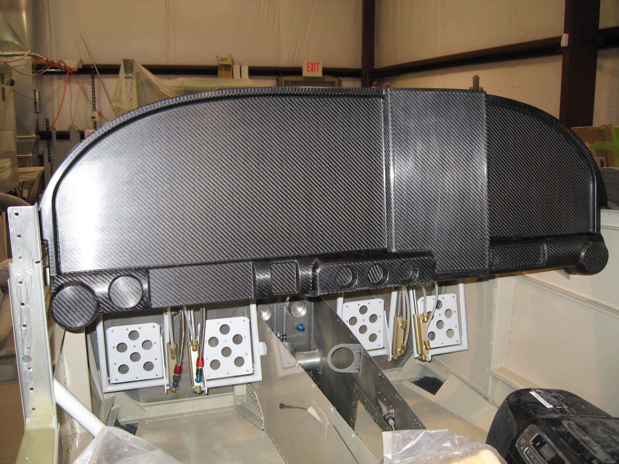

PostPosted: Sun Jan 11, 2009 5:39 pm    Post subject: Re: EFIS - Dual screen AFS advanced deck Reply with quote

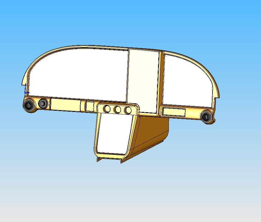

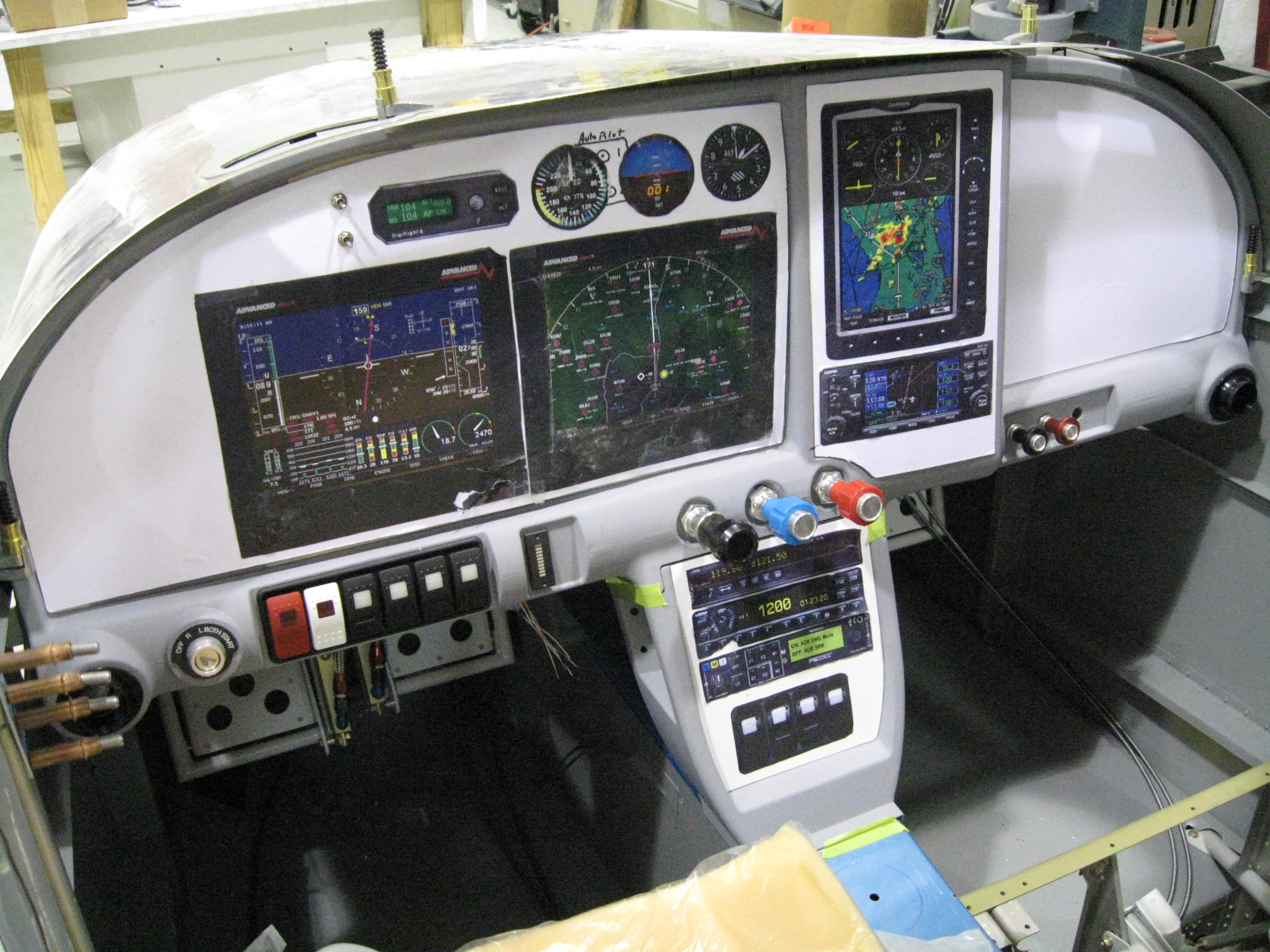

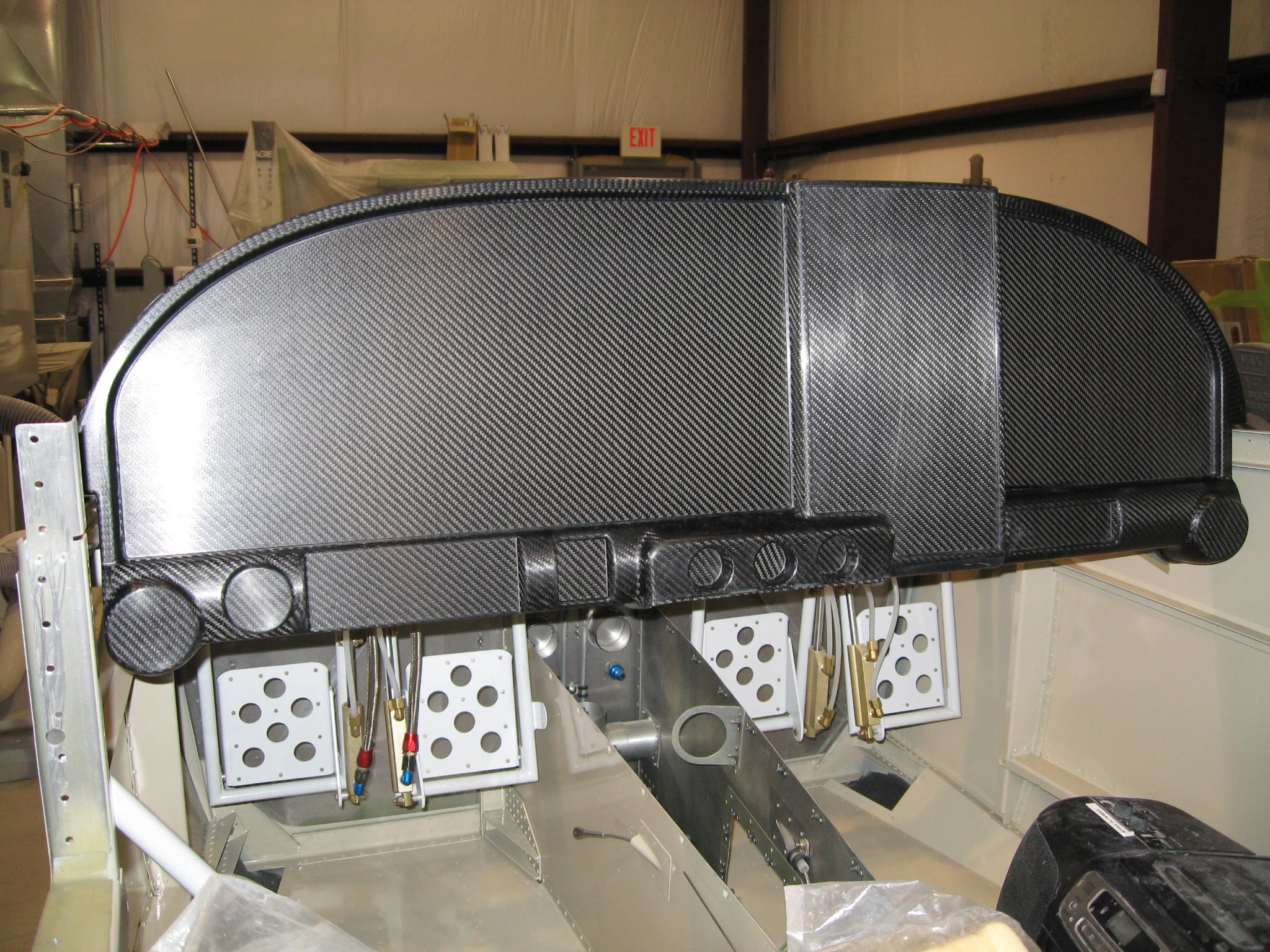

I have developed a new panel for the RV-10 I am building and it will hold 2 AFS advanced decks side by side. Here is a picture of the prototype
mock up in my Rv-10. In this picture the backups are above but I will put them on the left side running vertical.
New picture of the carbon panel

Rick, looks nice. How tall is the panel? Looks like Stein has a blank that is ~1.5" taller than Van's stock. I'm 6'5" so knee/leg room is key for me.
Doug
