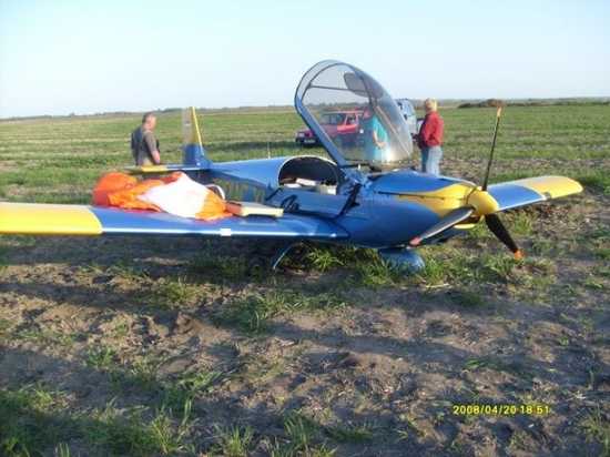

It has already been tested and (as I recall) the pilot and passenger walked
away. Picture attached. Was it Poland or the Czech Republic?

I believe it was Minnesota. See:
http://brsparachutes.com/files/Documents/Press%20Releases/PR%20Saves%20212-213.pdf

That is amazing. I can't put a screw in the canopy without causing a crack yet this one can have a rocket go off inches away and not damage it.
Look at the gear on that thing. It pulled MANY G's on impact and yet the wings stayed on.

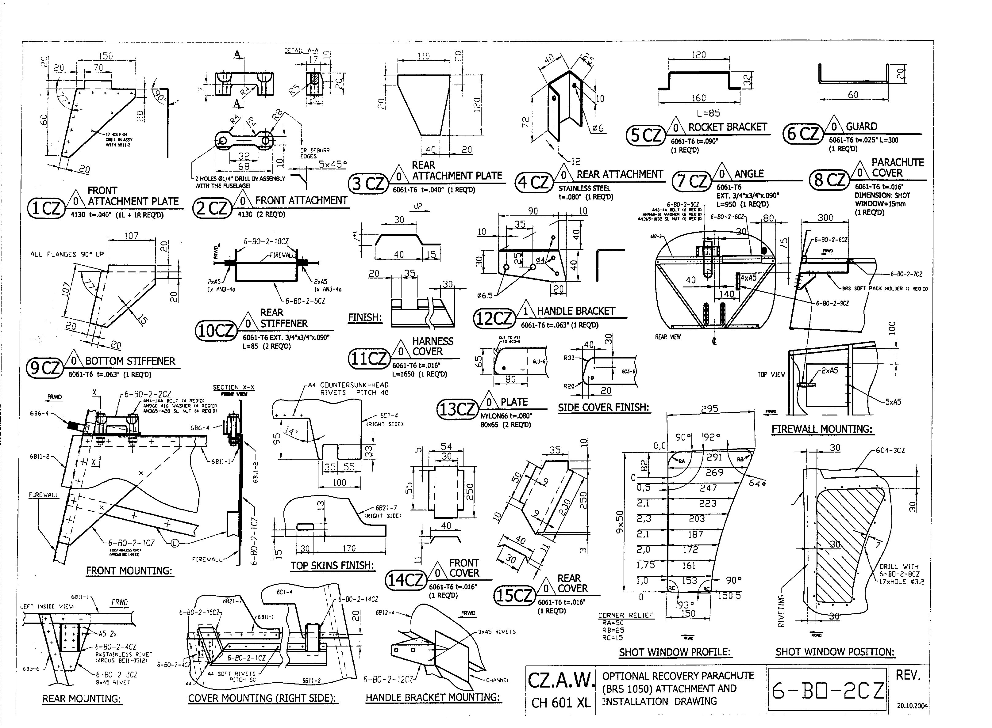

If anybody is interested in where the CZAW and european ULM versions have their BRS installed, have a look at the ULM-drawings (6-UL-5).
I am not sure if the 600kg BRS-version would fit right behind the firewall? The ULM version only needs the lighter 450kg parachute.

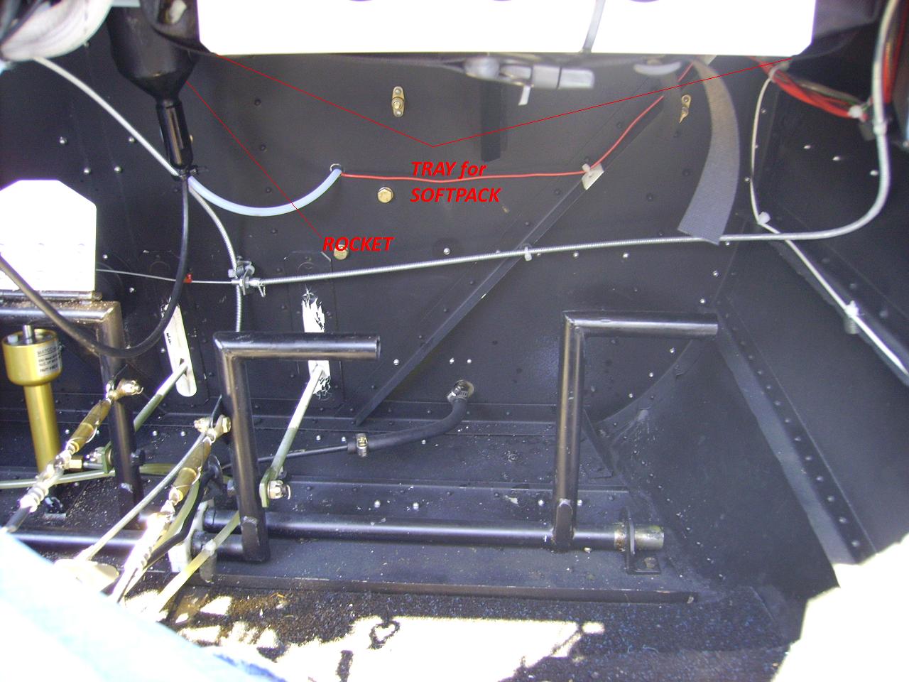

have a look at drawing and pics to see forward installation (std CZAW)

PatrickW
Joined: 27 Oct 2006 Posts: 380 Location: Fort Worth, Texas
Posted: Thu Jan 08, 2009 11:49 am Post subject: Re: W&B 601XL |
| alex_001 wrote: | | have a look |
Thanks for sharing those, Alex.
- Pat
