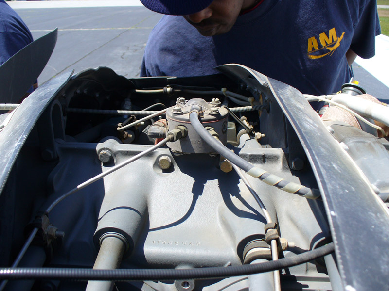

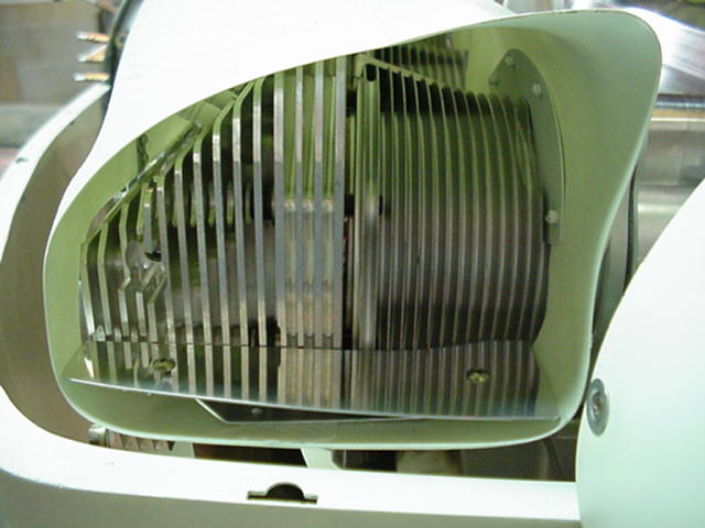

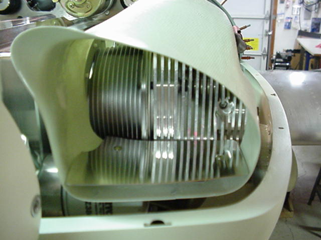

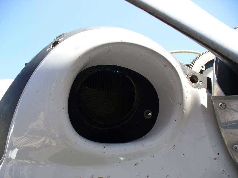

tjs22t(at)verizon.net
PostPosted: Fri Dec 19, 2008 1:21 pm    Post subject: Engine Cooling Reply with quote
Bobby,
Aside from what's has been said about the baffles between the cylinders AND the deflectors in the RamDucts just ahead of cylinders 5 and 6; keep in mind that the lower the pressure in the bottom portion of the cowl the greater the airflow down through the heads. To do this make sure that the front of the air intakes to the ducts through the cowling have NO (or as little as possible) air leaking under cylinders 1 and 2 and thus into the bottom of the cowl (pics attached). Also, the air coming into the oil cooler through its duct/intake should ONLY go through the oil cooler. Any air leaking around the the edges of the intake greatly, greatly defeats your low pressure area in the lower cowl. The difference in pressure between the top and bottom cowling segments is as important as total exit area at the rear of the bottom cowl lip.
tailwinds jeff HDS/3300 (no CHTs over 285F)

pete(at)usjabiru.com
PostPosted: Fri Dec 19, 2008 2:13 pm    Post subject: Engine Cooling Reply with quote
Attached is the procedure for installing cooling ducts from the Jabiru manual available on the Jabiru Australian web site. We do block off the air from going in the bottom cowl but use a vertical air dam instead of the horizontal pieces that Jeff used.
Jabiru makes the dam from fiberglass but there is no reason that scrap aluminum sheet if Zenith builders don’t want to mess with the fiberglass.
Pete

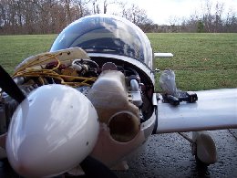

Afterfxllc(at)aol.com
PostPosted: Fri Dec 19, 2008 10:09 pm    Post subject: Engine Cooling Reply with quote
Brady
With all due respect, how many aircraft have you built? You are starting to be the WW of the Zenith list. I think you are a smart guy and like what you are trying to do but wouldn't it be better to have built at least 1 airplane before you hand out answers to others problems? Having worked on a Jab that overheats it is a pain in the ass engine when it comes to cooling. Jab will tell you they don't have a problem but I have seen too many posts about overheating to believe that.
BTW if the intake is small where is it going to "Suck" the air from? The Jab uses small deflectors inside the baffles and if they are too big or small the rear cylinder will overheat.
Jeff

PostPosted: Sat Dec 20, 2008 6:44 am    Post subject: Engine Cooling Reply with quote
Roger,
You are right to a point but there is no better teacher than experience. I didn't want to sound harsh with my comment to Brady but after reading it again it was just that. I am working on ram air ducts for the 601 and 650 to fit our new cowling and while it looks like it should work in theory will it work in the air?

BobbyPaulk(at)comcast.net
PostPosted: Sun Dec 21, 2008 3:17 pm    Post subject: Engine Cooling Reply with quote
all,
many thanks to Jeff for the photos and logic to help solve the high temps on the rear cylinders. also to Randy who has the same problem. i had tried adding an 1 1/2" skirt to the bottom of the cowl to no avail. i have also tried large deflectors in the ram air ducts. i also trimmed them 1/8" at a time until i wound up with small deflectors. the oil cooler is sealed tightly as is the ram air ducts to the cowl openings. i will keep experimenting to find the right combination.
thanks to all who offered help. i will post the findings when you or i solve the problem.

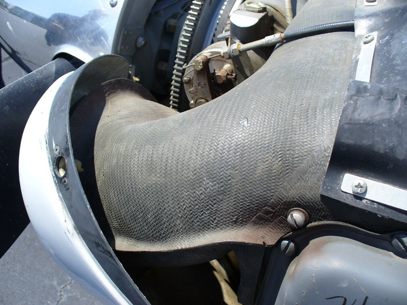

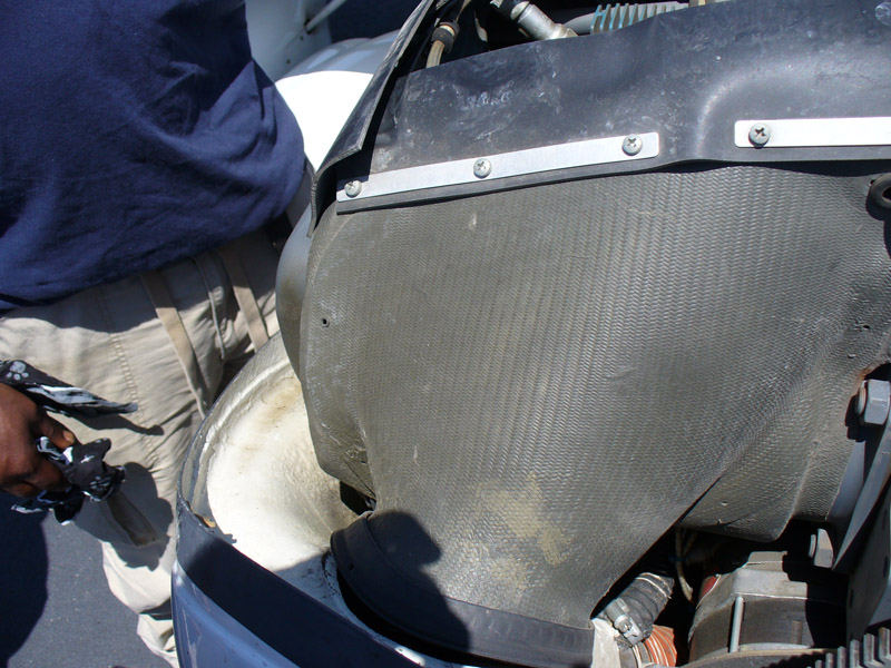

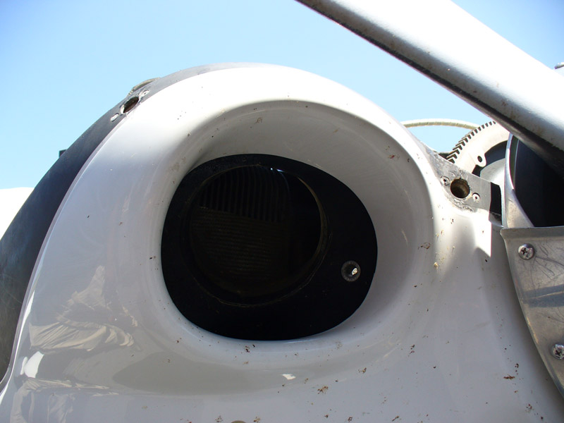

PostPosted: Tue Dec 30, 2008 10:33 am    Post subject: Engine Cooling Reply with quote
Better than ram air is a defuser. If you look at modern versions of older designs the cooling air inlet area is now about 30% of what they were. The air path forms a divergent duct. By Bernoulli's principle the air slows down and pressure goes up. Manufactures look for a pressure drop from top to the bottom of the engine. One plane I have worked on needed a 6" of water pressure difference. Some aircraft use an augmenter exhaust to lower the pressure in the lower cowl. This uses the exhaust flow to create a venturi effect. The images are of a Diamond DA-40 with a 180HP Lycoming. The air inlets are about 6" in diameter. They feed into a plenum defuser. Air must be prevented from getting past the baffle seals. Also air will try to leak around the propshaft.
Teaching turbine engines at the moment,
Ken Lilja
