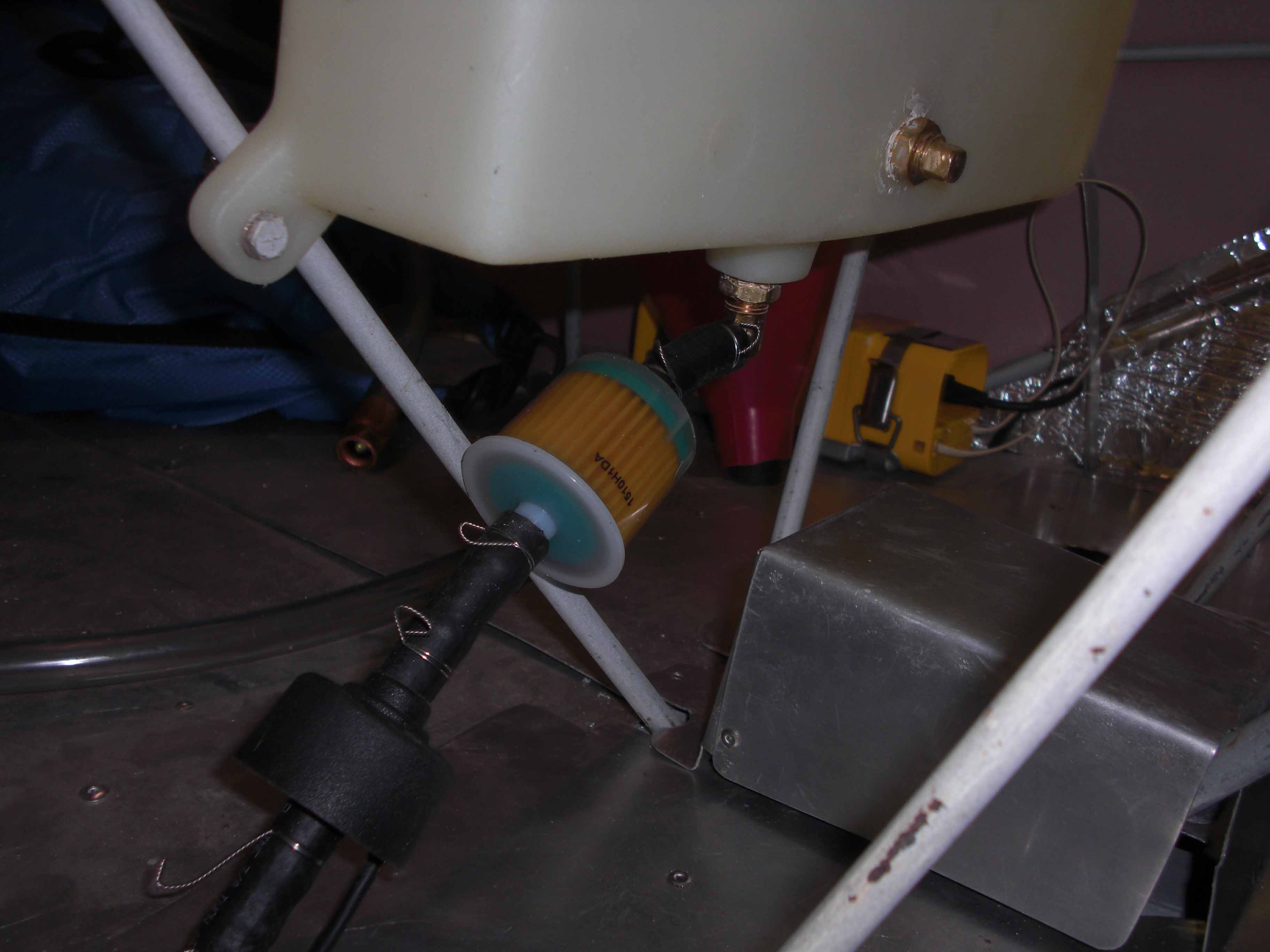

Lynn,
Mine is coming off the header tank behind the seat and I put about a 15% slope to it. It works just fine.
_________________ DO NOT ARCHIVE

Thanks Leonard...I might get away with a bit of slope to mine
too....drop the fuel line to the floor level of my console, a slight
bend up, then the transducer, then a slight bend from the transducer
to the roof of the console, then forward...ought to work.

Lynn,

Lynn, not being one to follow the crowd or be quick to do what I'm told, I
mounted mine horizontally. Their reasons have merit. However, if it's
mounted down low, like mine is, just after it comes out of the header,
there should be no bubbles as they will move toward the highest point and
away from the transducer. Once it's installed, just pump a couple gallons
of gas through it and any air in the system should be gone. Over 400 hours
on mine and no problems.
You're correct on how the impeller works.

It is a "turbine" in there not an impeller.... now you can brag about having a turbine in your kitfox....
Here are a couple pics of mine

Touche.... : )
